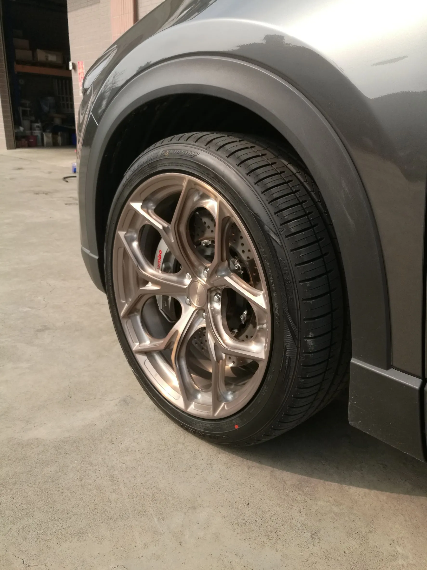

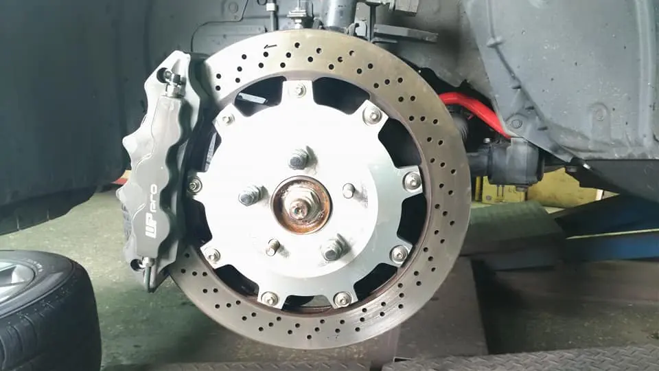

Ceika makes a customizable BBK. WP Pro also made a kit, but I can't seem to find the ordering site anymore. Here's a few pics of the WP Pro kit, which I saved from their website a while ago.
