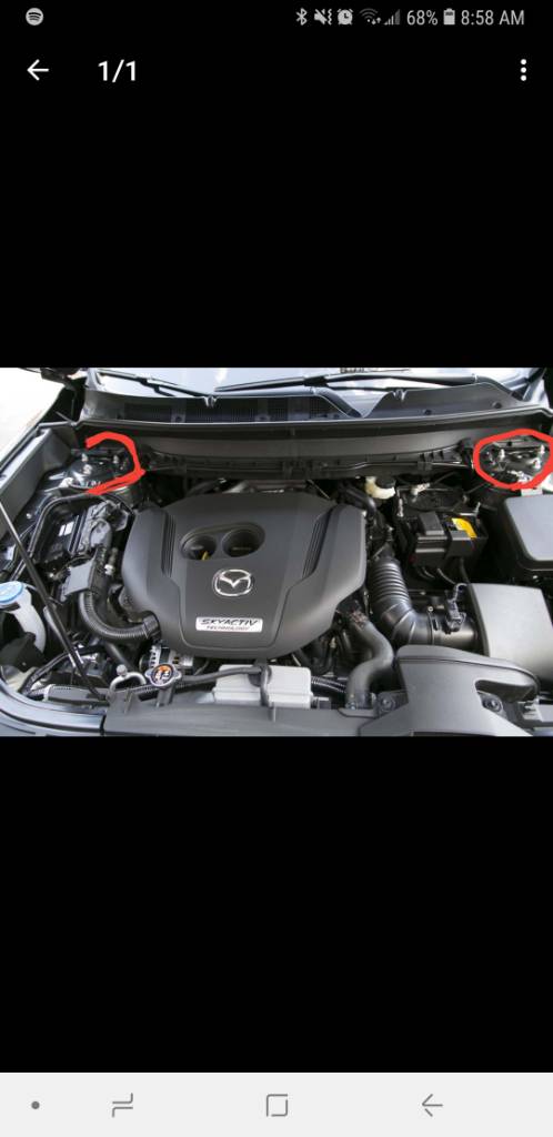

I just registered on this forum to report about what I thought was suspension clicking and clunking on my 2017 CX-9 with ~10k miles. It started happening more and more the last couple thousand miles. Happened everywhere--inclines, driveways, on the highway when hitting bumps OR when coming off bumps (suspension unloaded).
I jacked it up and couldn't find anything that seemed like it would make the noise, but then I happened to notice the upper strut tower bracing/bar that at the base of the cowl/top of firewall had four bolts that were all loose! Tightening those got rid of my noise.
I hope this helps anyone, though I suspect that's not the cause of the sound the OP in this thread is demonstrating.

Could you please post a pic of the area you tightened on your CX-9. Thanks!

Thank you! I tightened mine yesterday afternoon (one was actually so loose that I could spin it with my hand) and it immediately fixed the issue. I'm glad this was such a quick fix and was nothing major.
Just inside each strut tower (the towers each have 3 silver bolts/nuts) there is a brace/bracket between the two towers (black horizontal bar in picture below). Each end of this bracket has 2 black bolts/screws that hold it in place and these are what need to be tightened. 12mm IIRC.
