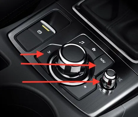

Thank you for this fix. To clarify, it is the buttons around the main control knob. I attached a picture. To me, it is the back button, the NAV button and the volume button. See picture below:
