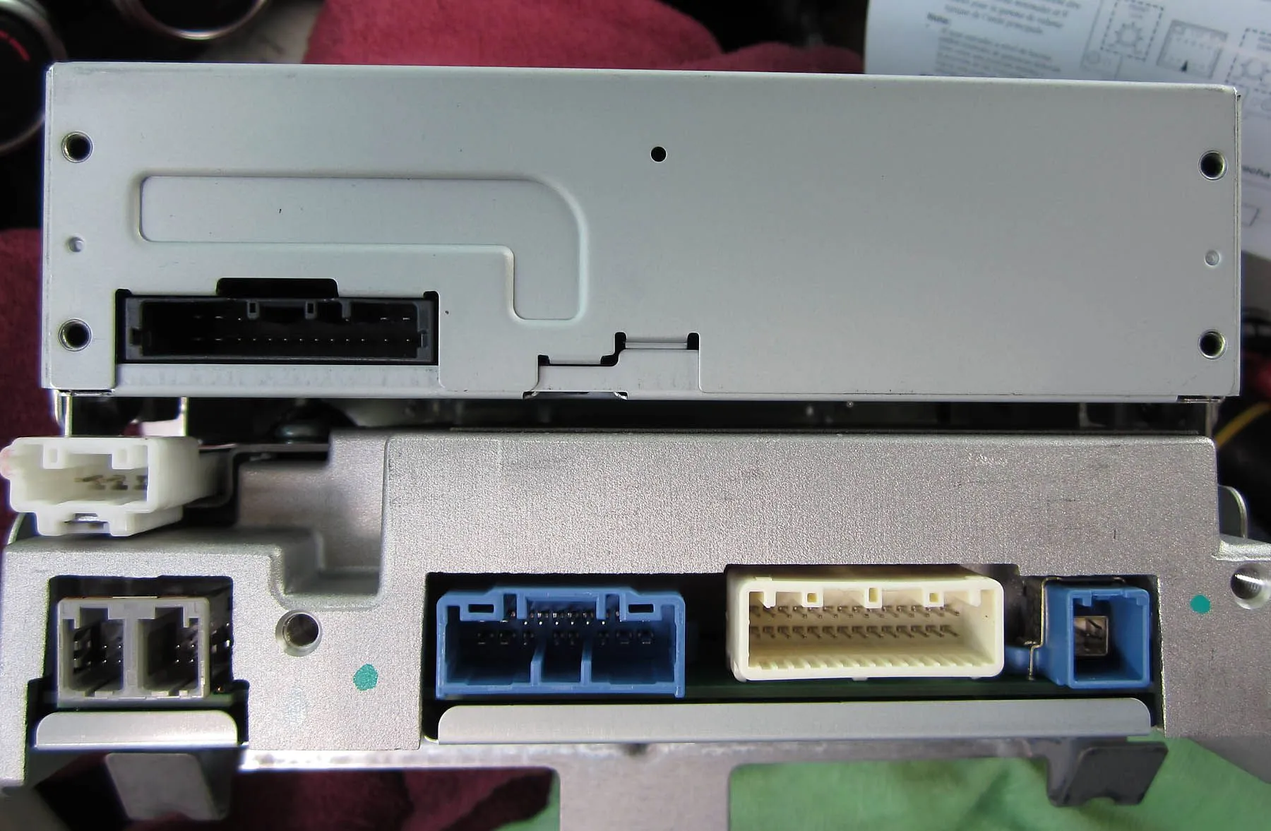

In the meantime here's what the back of the 2016 non-Bose head unit looks like: radio_backside_011.webp

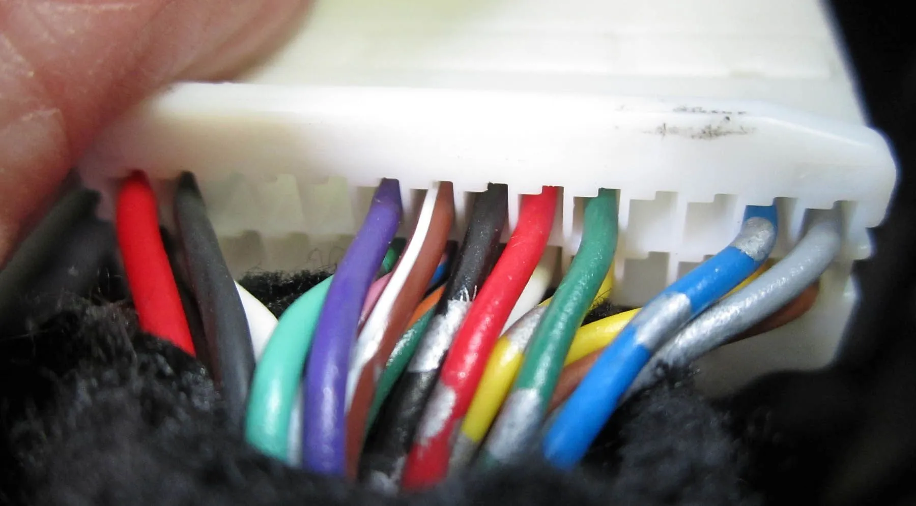

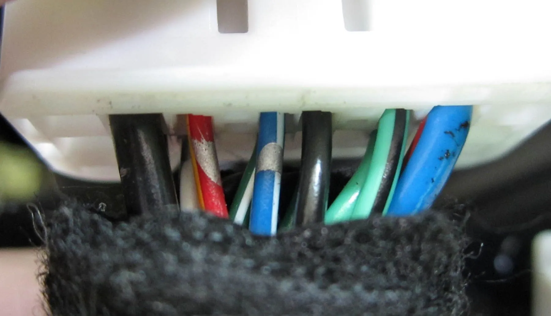

The speaker wires are in either the blue or white longer plugs that are sitting next to each other. Here's what the wiring in those plugs looks like:

In the meantime here's what the back of the 2016 non-Bose head unit looks like: View attachment 211540

The pinouts for the speakers are the same as in previous years. See post #2 in this thread.
The colors of the wires have changed in 2016 but the positions in the plug are the same.
