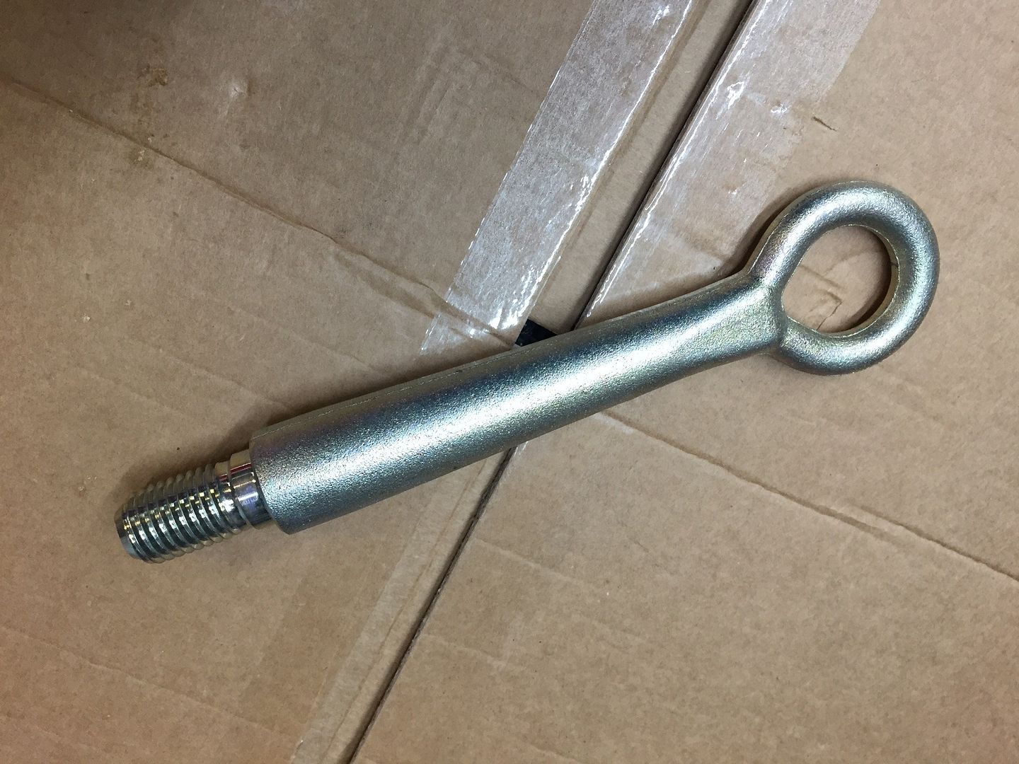

This is the spare. It's about 6 or 7 inches long and really heavy. I can measure it properly when I get home if you like.

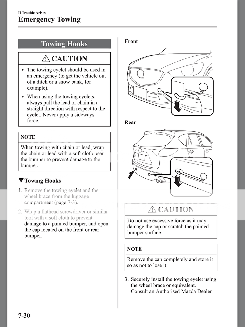

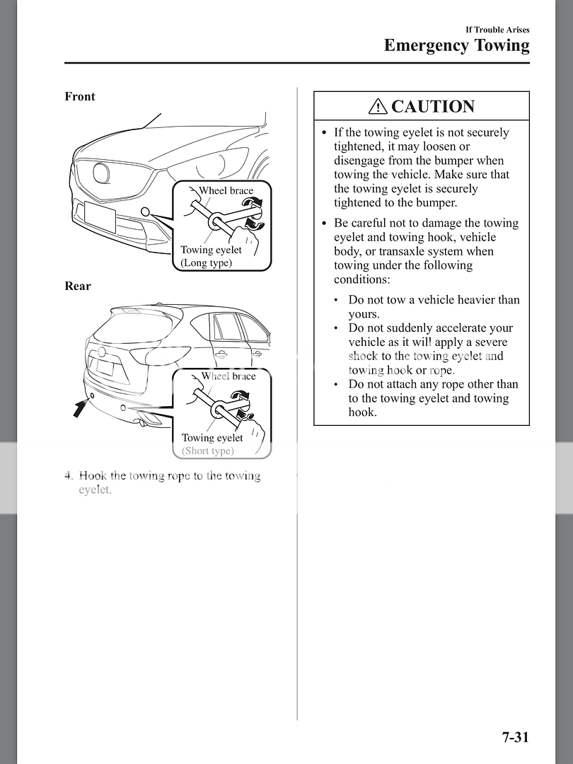

Yes, according to the manual. I've attached the 2 pages
