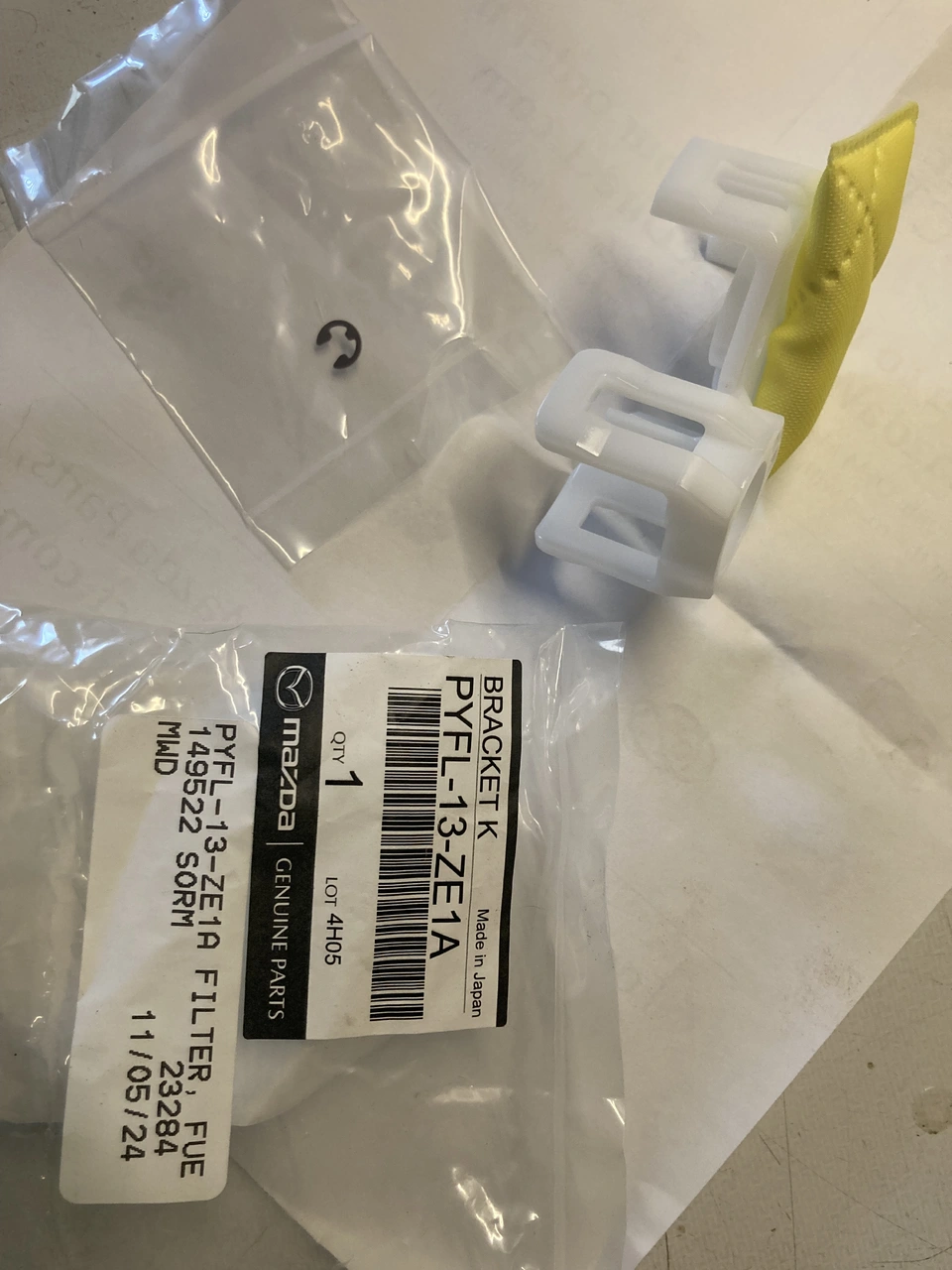

I suspect fuel filter needs to be replaced. One ordered and due to be delivered tomorrow.

Part came in today’s mail. Any guesses as to how long the install should take?

New filter was finally installed yesterday. Removed right rear seat from the car so I could slide the larger left end of the bench to the right side of the car without having to remove it from the car. Old filter was dirty but wasn’t the culprit.
