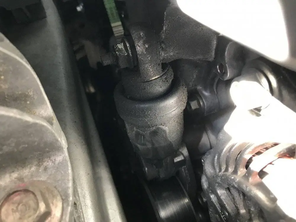

Shouldn’t be surprised. Actually I was surprised your belt tensioner doesn’t leak at 100,200 miles. Many belt tensioner went at as low as 30K miles including mine at 42K miles. There’s a TSB for leaky belt tensioner and there’re at least 5 revisions for the tensioner. You may not hear any squealing noise when the belt tensioner is leaking.

As yrwei52 said above, it's a well known and documented problem with many revisions of the tensioner. Mine was leaking at 29,000 miles and I recall the dealer service department state that they see a lot of them leak at around 40,000 miles. It wasn't a covered item under the 5yr/60k powertrain warranty and I was past the 3/36 warranty, so no help from Mazda.

There’s very little thick oil in the belt tensioner. If your tensioner looks wet like mine at 41,150 miles, it’s leaking:
If the rib side of serpentine belt has cracks, it’s about time to be replaced. And at 100,200 miles, certainly it’s about time.

I inspected my one I tried taking a picture but it's a tricky area to put a camera in. My one is dirty but it doesn't have baked on, thick dirt like your. It's not leaking, belts look perfect too.
If your belt tensioner looks clean and dry, it’s fine. If the serpentine belt doesn’t show any cracks on the rib side when you bend it, it’s fine too.
