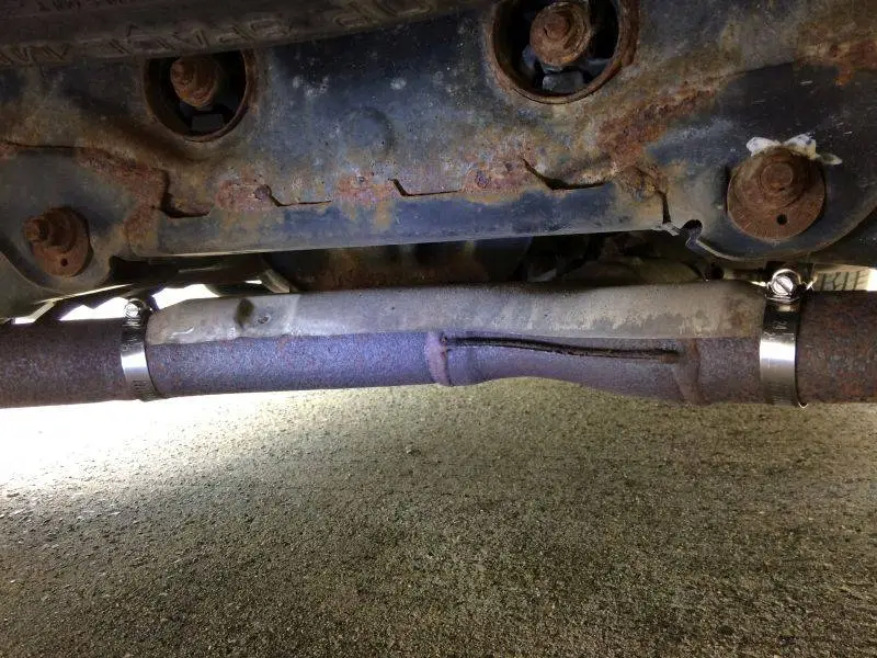

Sounds like an exhaust shield vibrating; check them all. There is one right behind the rear axle where the exhaust Y's, and on mine, the clamps were all gone. Two hose clamps later and she was good to go.

I will definitely ask them to check on the exhaust shield as the car is still with the mazda dealer
