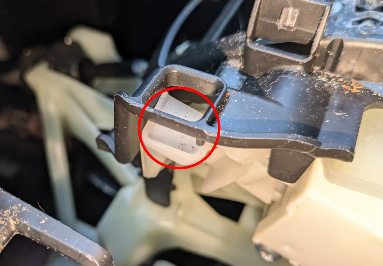

I replaced the park switch on my CX5. There is a small plastic part that clips on the front part of the switch. I noticed that I the legs with the clips on it got stretched out. I put it back on and it did clip in place but probably not as well as it should. It is just a little molded plastic part and should be pretty cheap to replace.
Here is a picture and I've circled part of this part that is visible in the picture. It is a little bigger than this and some of it is hidden in this picture.
Does anyone know what the part number or name is for this part?

I read through that thread and looked a few videos on installing a new switch before doing it. I can find a replacement switch, but the part I'm wondering about attaches to it.
One of the videos does talk about this part a bit, I thought it also mentioned a spring that was part of it. I didn't see any sort of spring, so maybe the part has changed. The video didn't give a part number and the description wasn't real clear.
