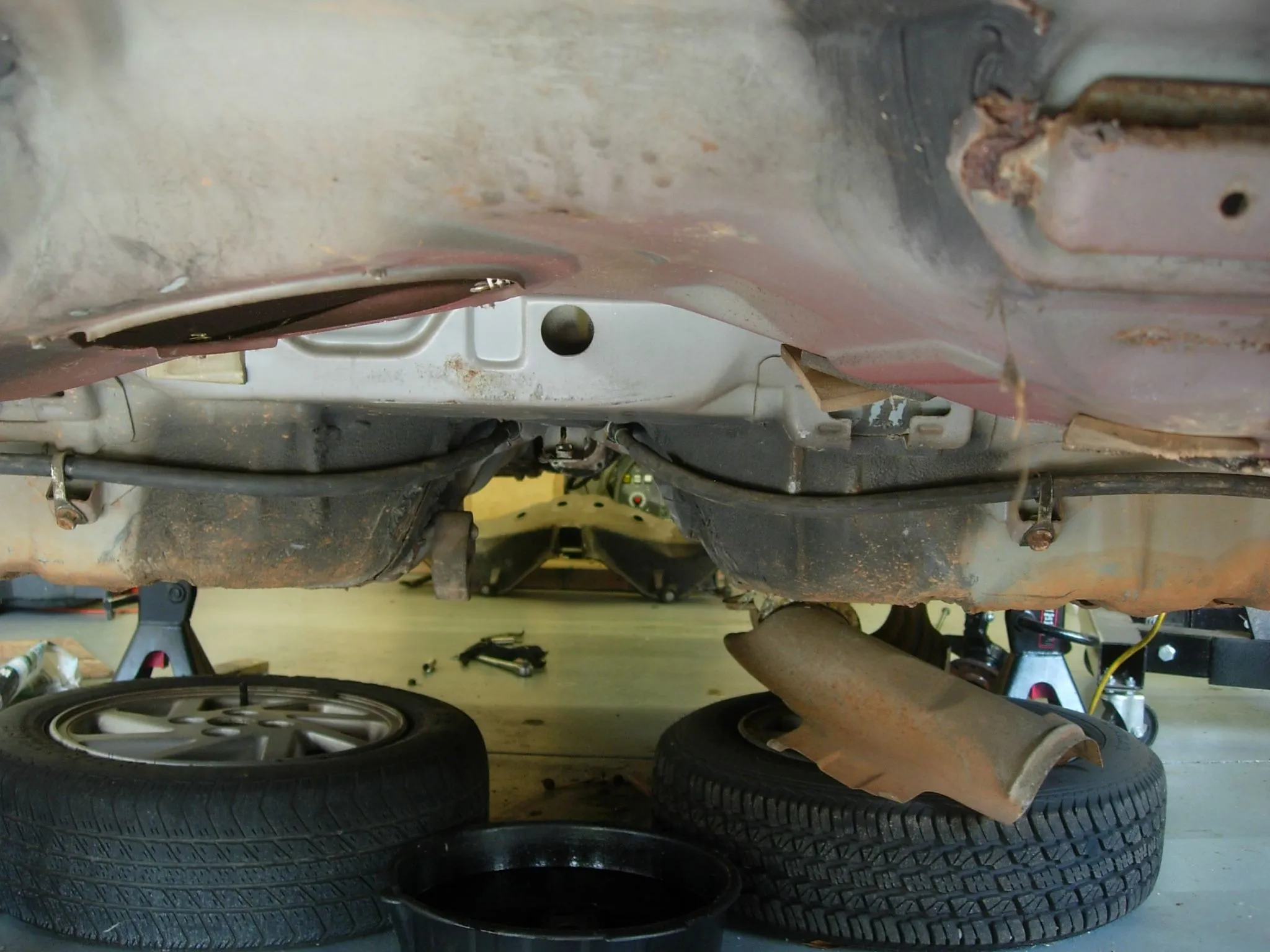

At this point I'm into this build with less than $500 spent, believe it or not! With the front of the car at a point where I'm sure everything will work as I would like it to, it's time to see about making the rear wheels turn under power.

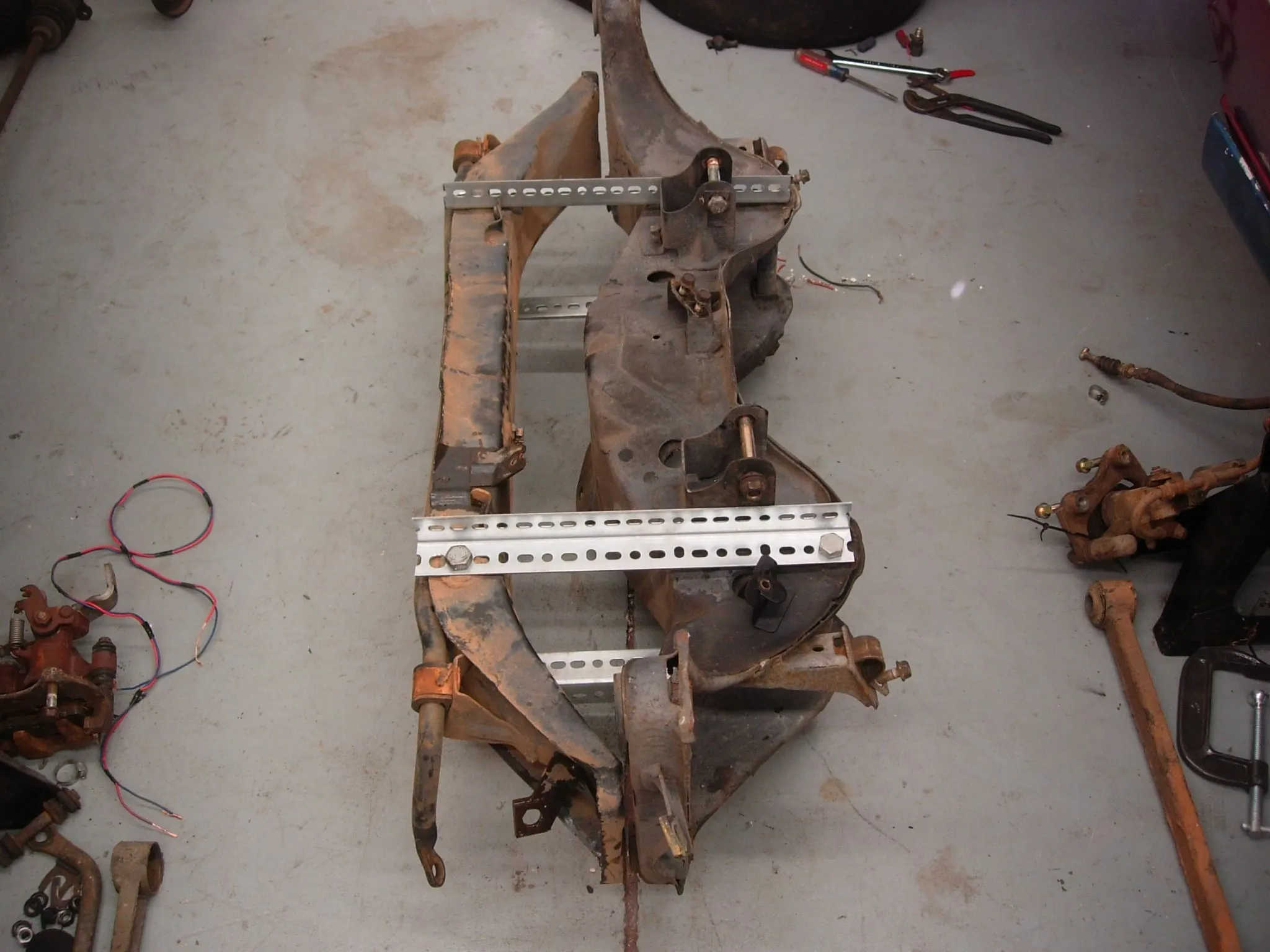

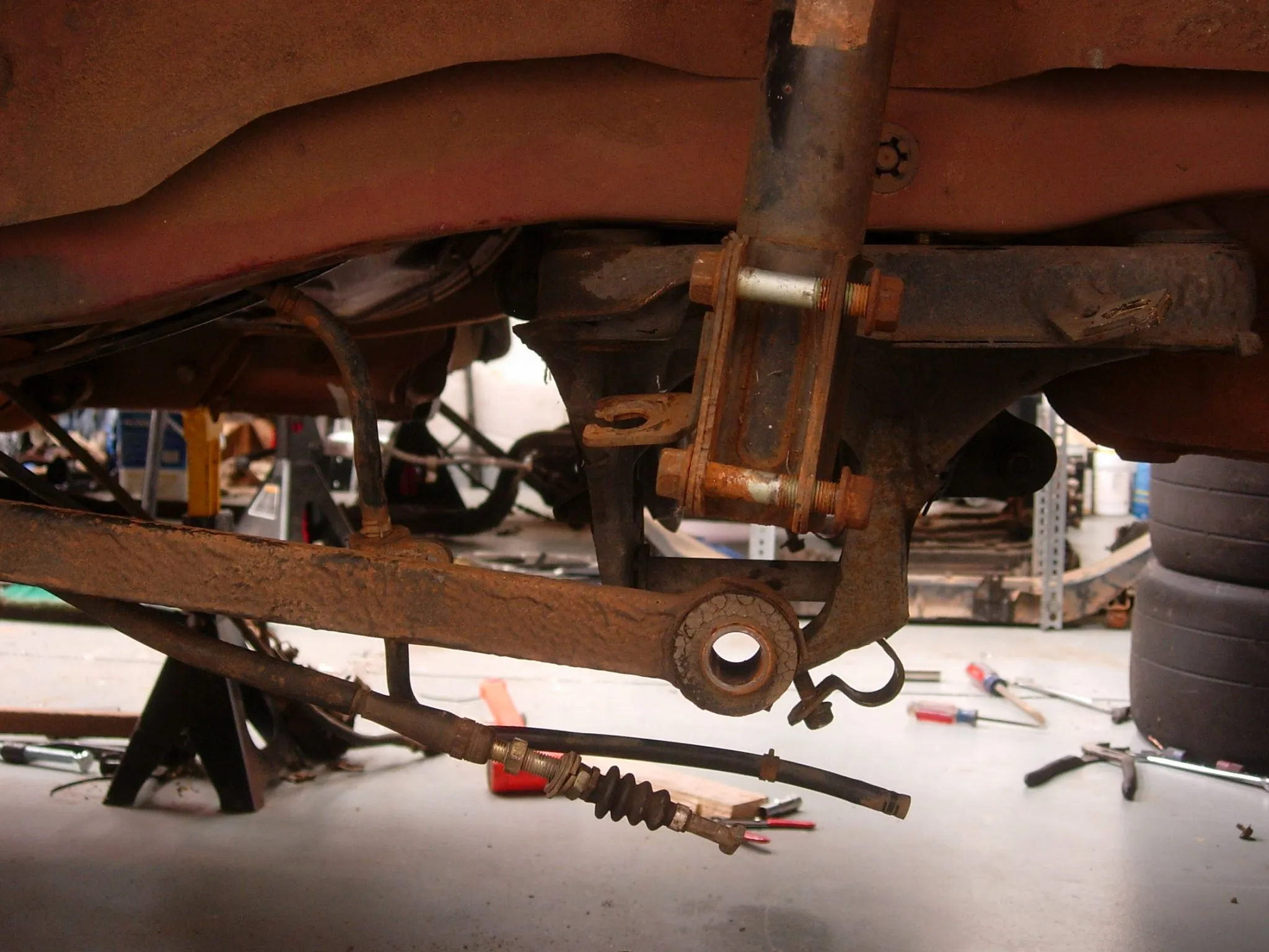

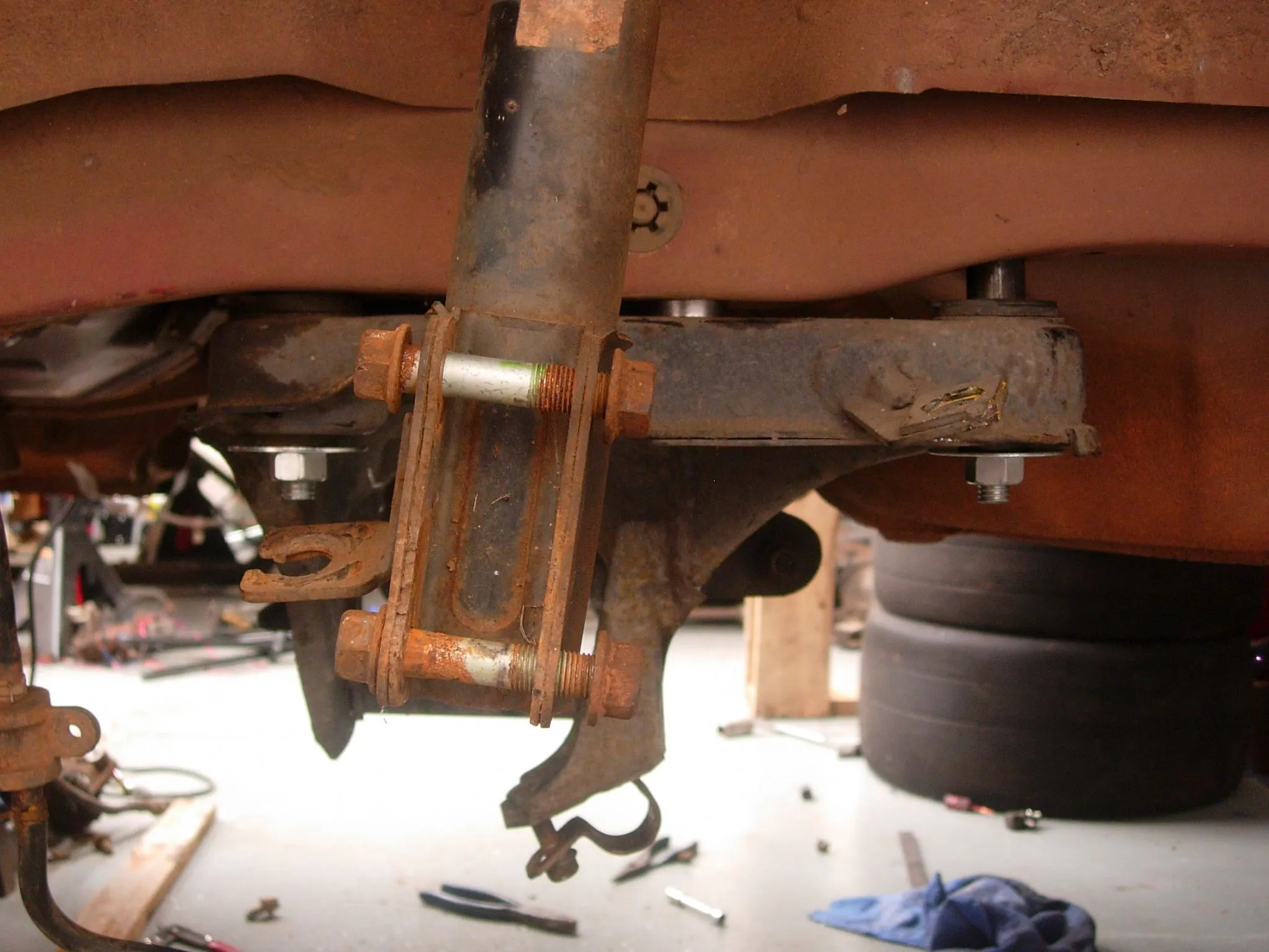

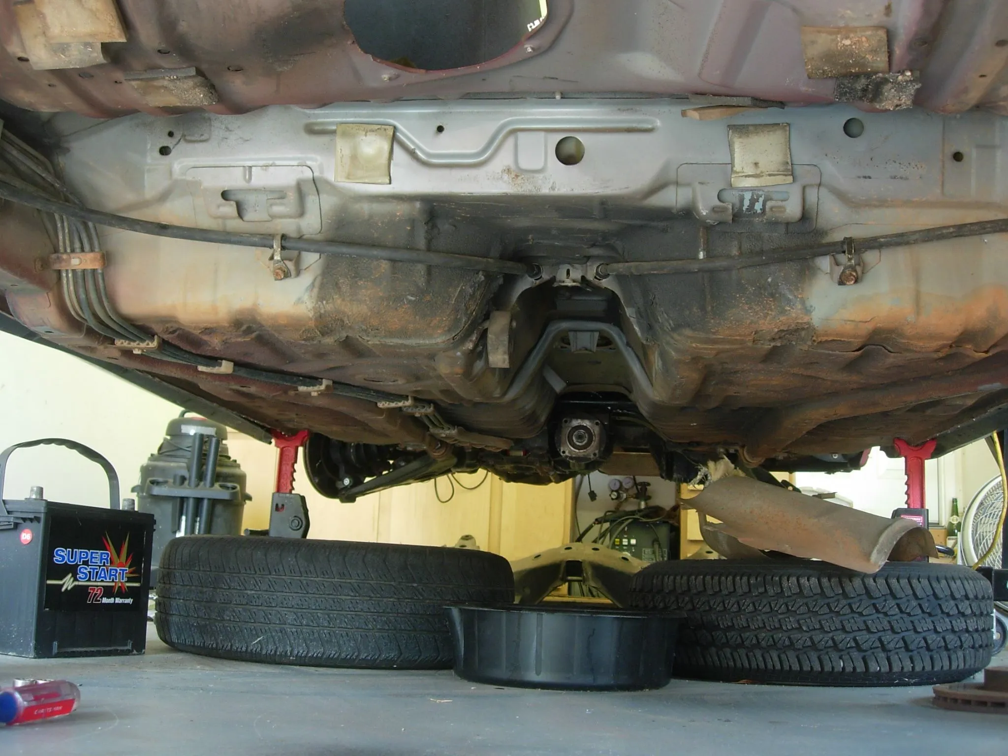

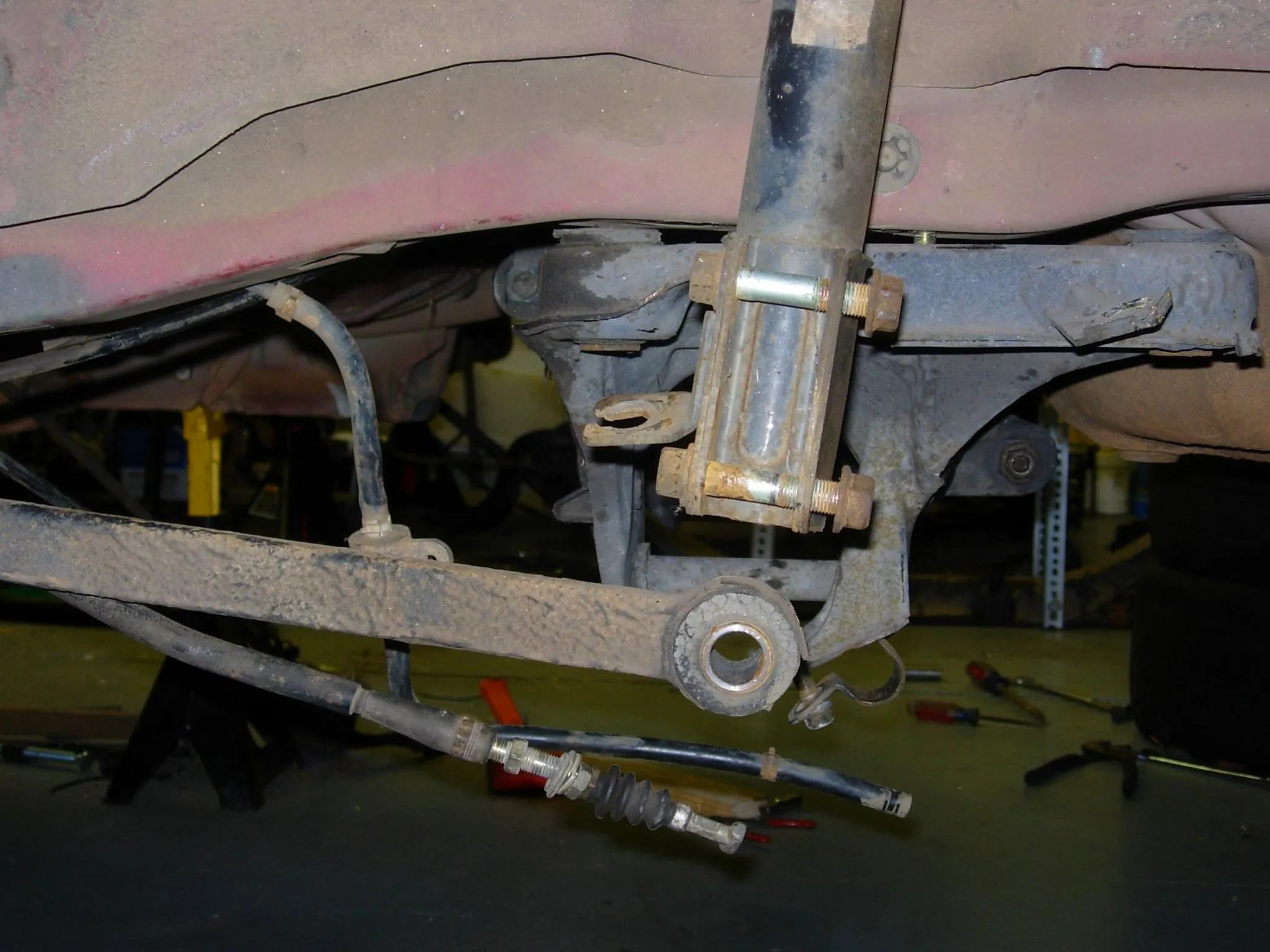

I started with removing the rear subframe from the GTX. Fortunately, nearly everything came off relatively easily as rust was minimal. The trailing arms are still stuck to the hubs and will need to be removed, but I'll get around to that in the next few days.
It's interesting to note that the suspension geometry and parts between the two cars are nearly identical. The trailing arms and lateral links share exactly the same measurements, however the Tracer's trailing arms are a touch beefier and the GTX's rear most lateral links are both adjustable where as only one of the Tracer's is. At this point, it looks as though the GTX's rear wheel spacing is about a 1/4 shorter than that of the BG's.

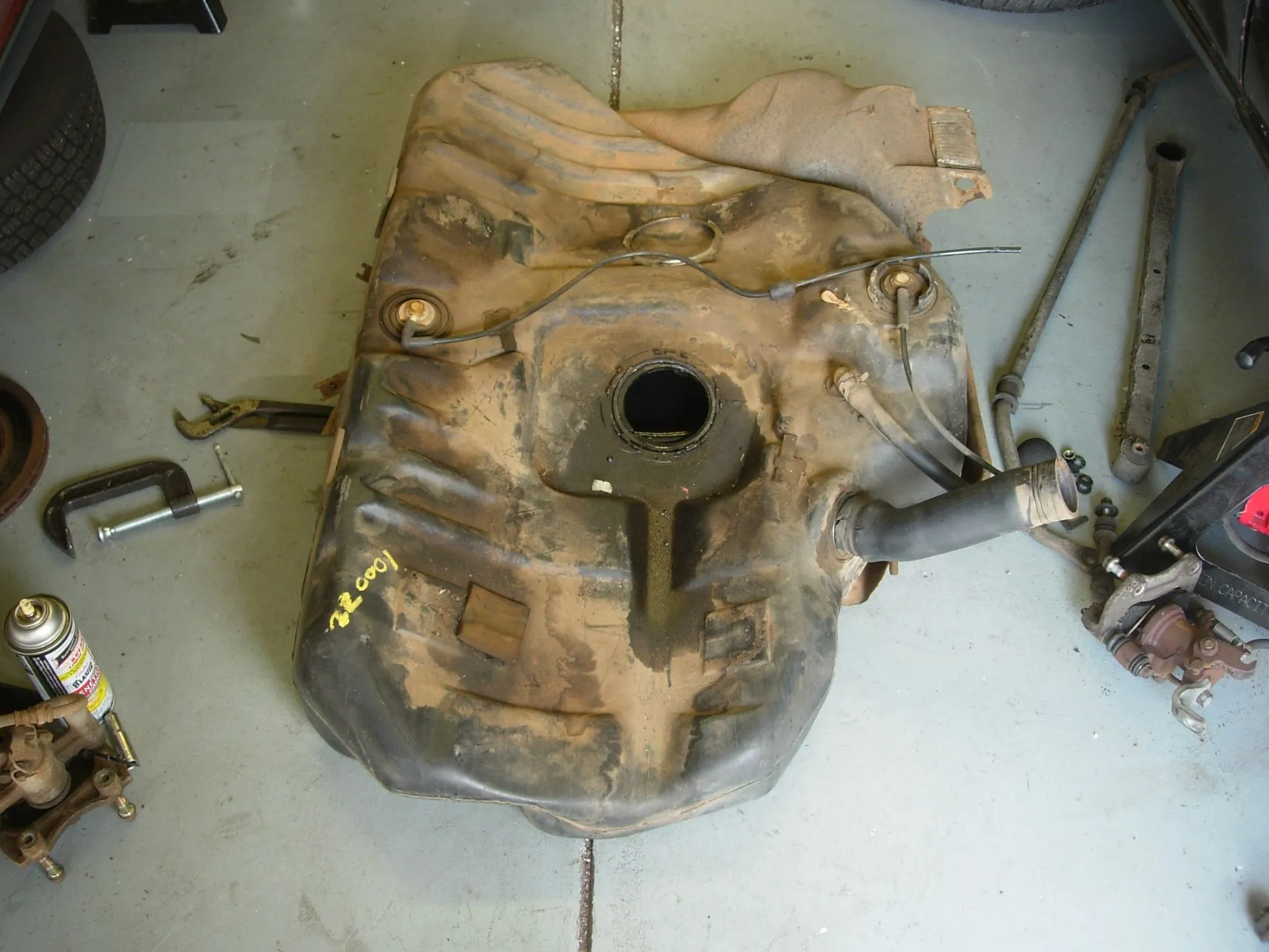

Of course, the entire rear end of the Tracer had to be disassembled along with it went the fuel tank. I'll have to use the GTX's fuel tank since it allows clearance for the drive shaft whereas the Tracer's does not.

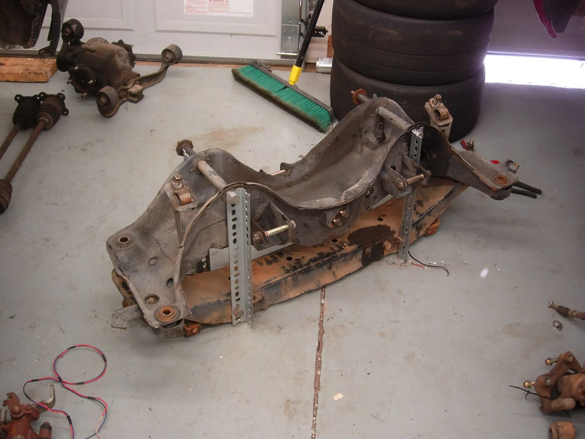

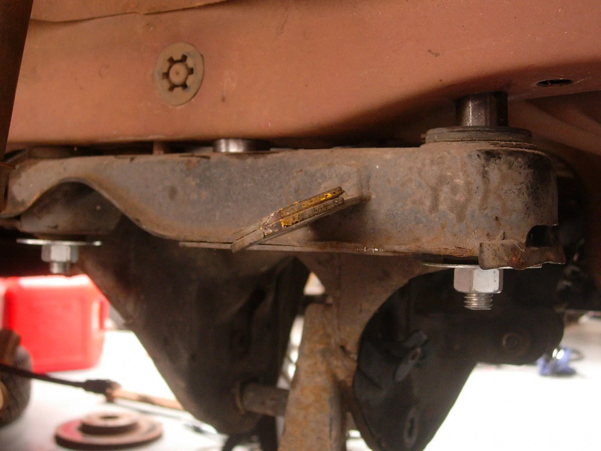

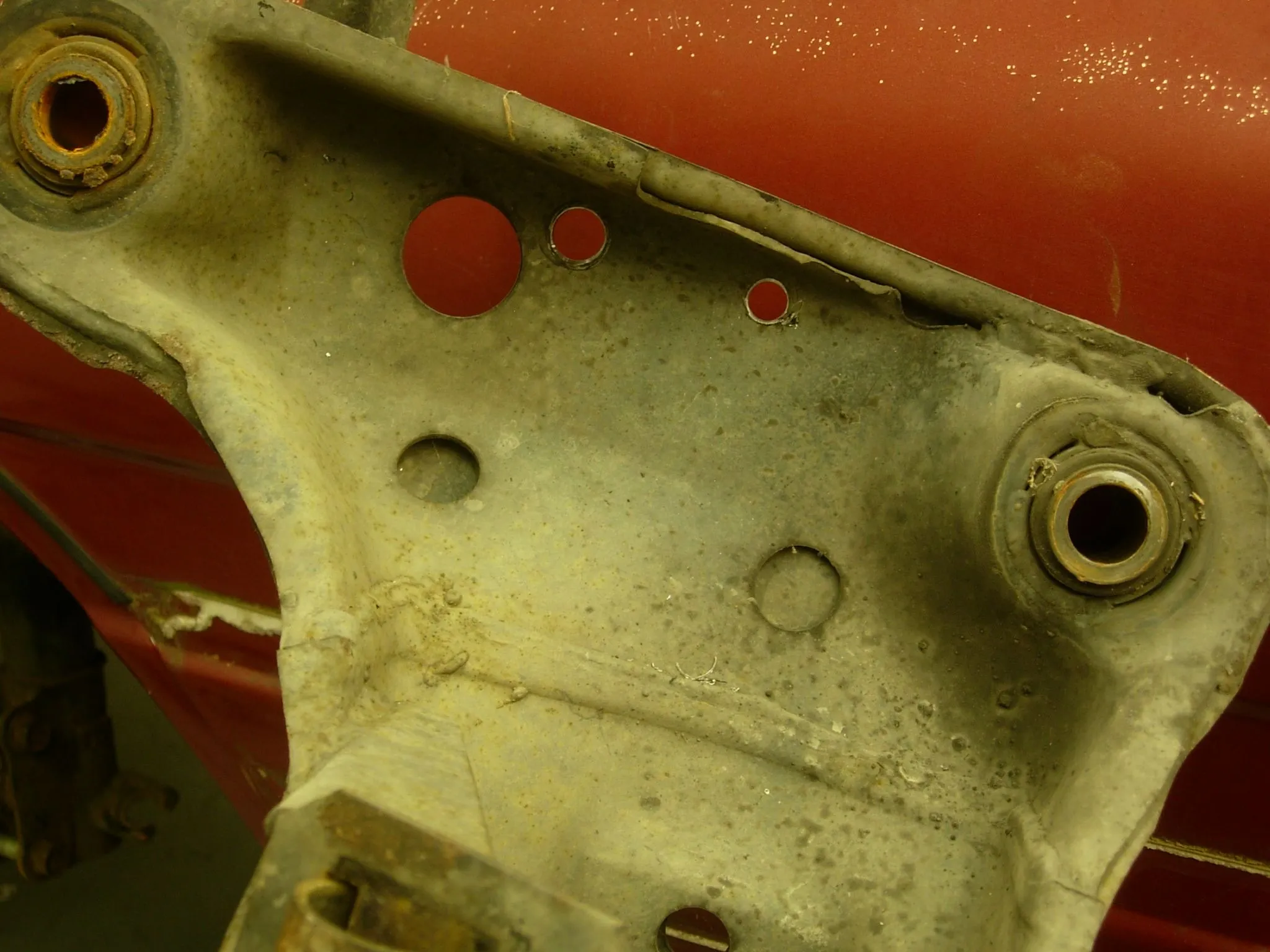

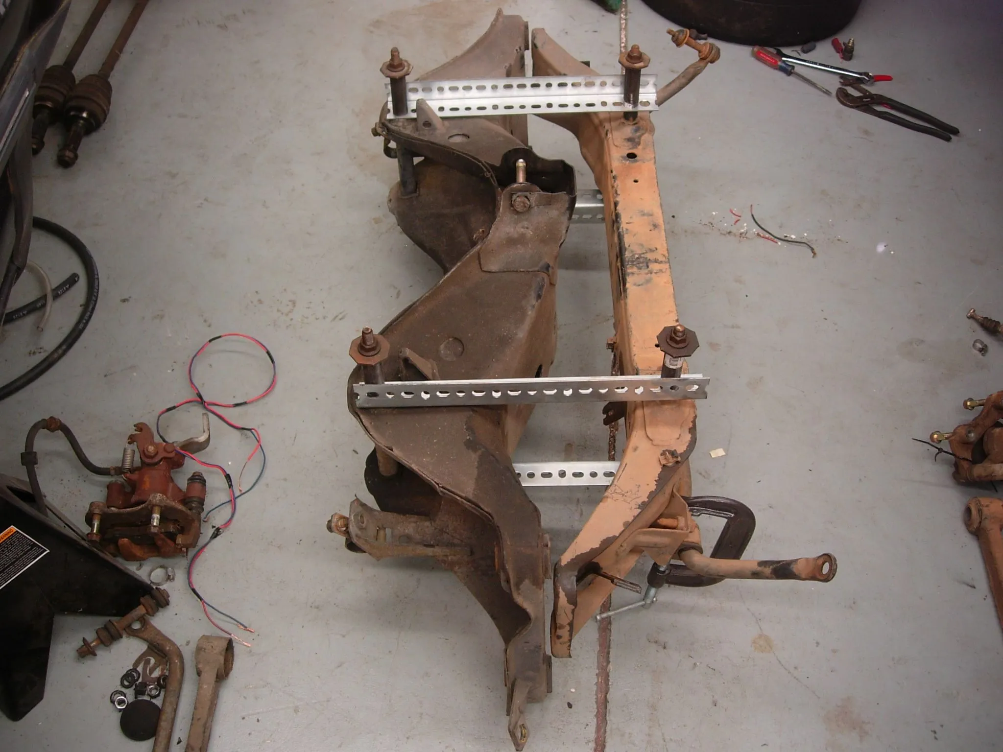

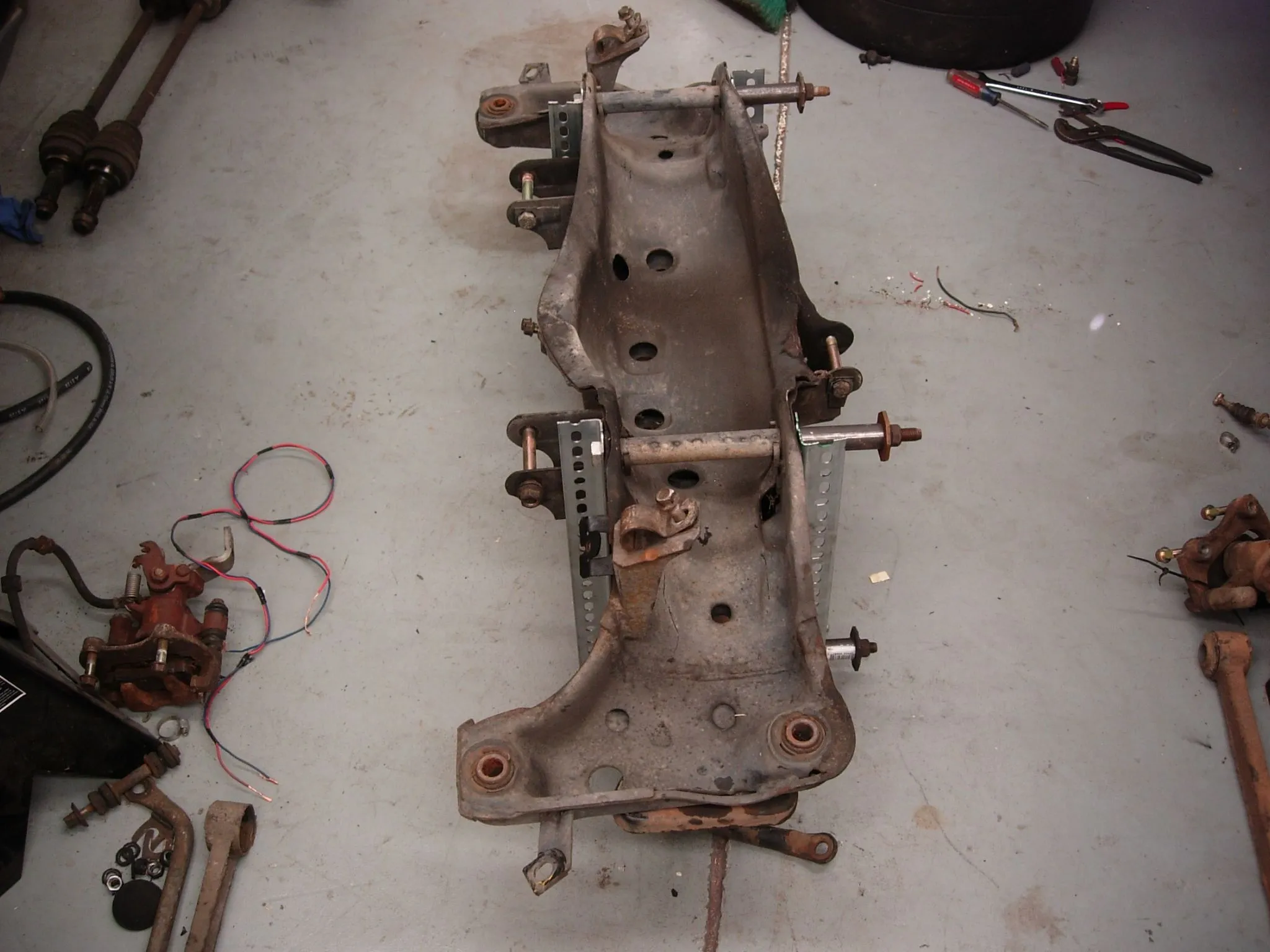

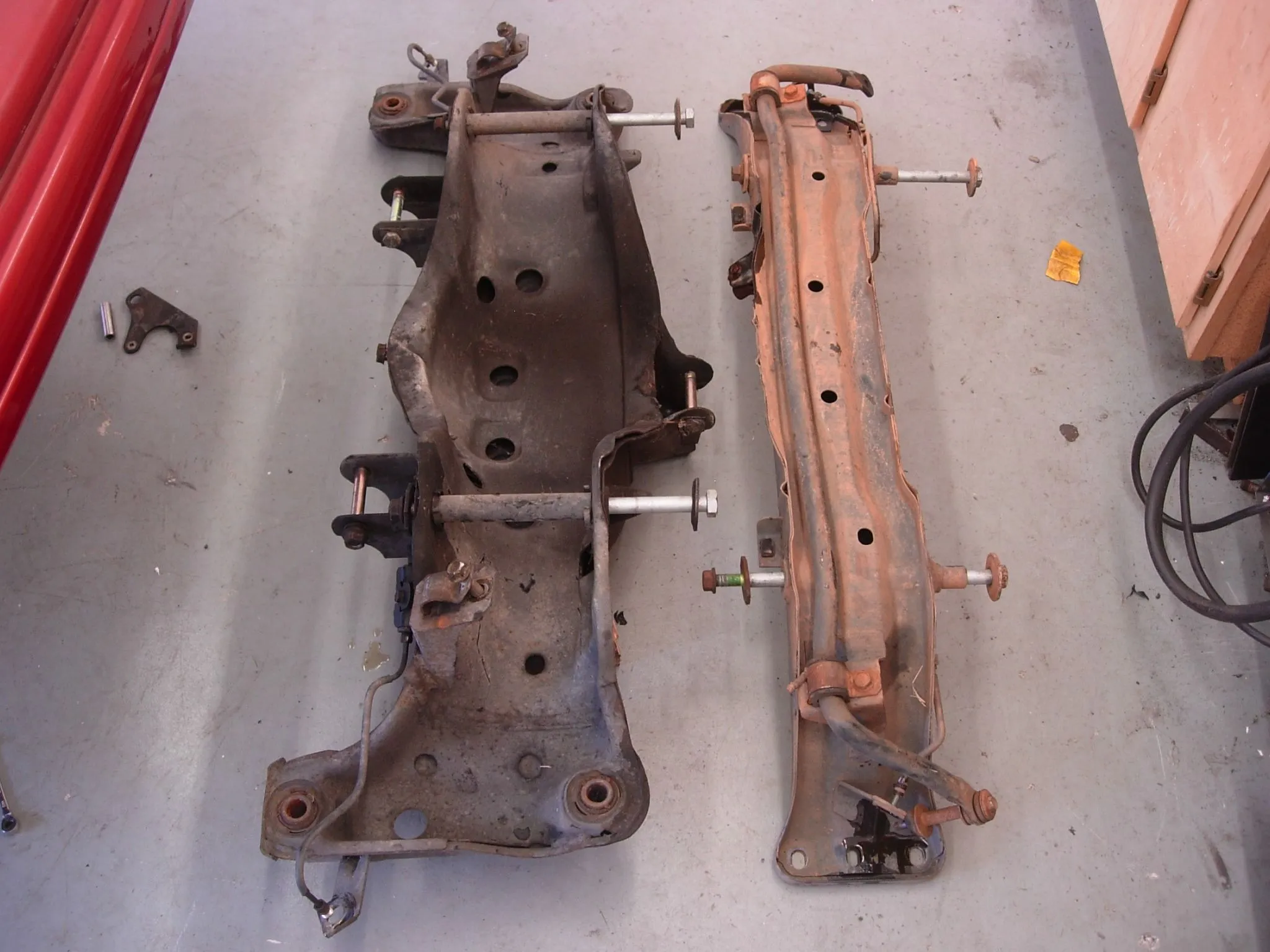

Both the Tracer and GTX's rear subframes mount to the chassis at 4 locations, 2 per side. However, the locations are quite different between the two cars. The GTX has 4 studs protruding from the chassis and the subframe is secured by nuts. The Tracer has 4 threaded bosses and two alignment dowels and the subframe is secured by bolts.
To properly align the GTX subframe, I flipped the Tracer's subframe over and secured it to the GTX's using common mounting points between the two, namely the inboard lateral link attachment points. This ensured proper alignment so that I could mark and drill the holes for the Tracer's alignment dowels and bolts. After measuring several times, I was convinced that everything was square and aligned properly and thusly marked and drilled the holes in the AWD subframe. I'm only able to use one of the original bolts per side to temporarily secure the subframe to the Tracer as there isn't enough clearance to allow use of the other two bolts.
Currently, the subframe is held in place only by those two bolts. I will mark each of the original mounting holes of the GTX subframe onto the Tracer and drill them through the unibody frame rails, running bolts into the trunk floor. I will also need to fabricate a few spacers to allow proper seating onto the unibody rails as it is loosely sitting in place.
A quick measurement indicated that everything will line up perfectly from the front to the back of the car. Furthermore, it appears that all of the rear suspension will also align properly. This was a little too easy, I wonder what hang ups lie in wait. :)

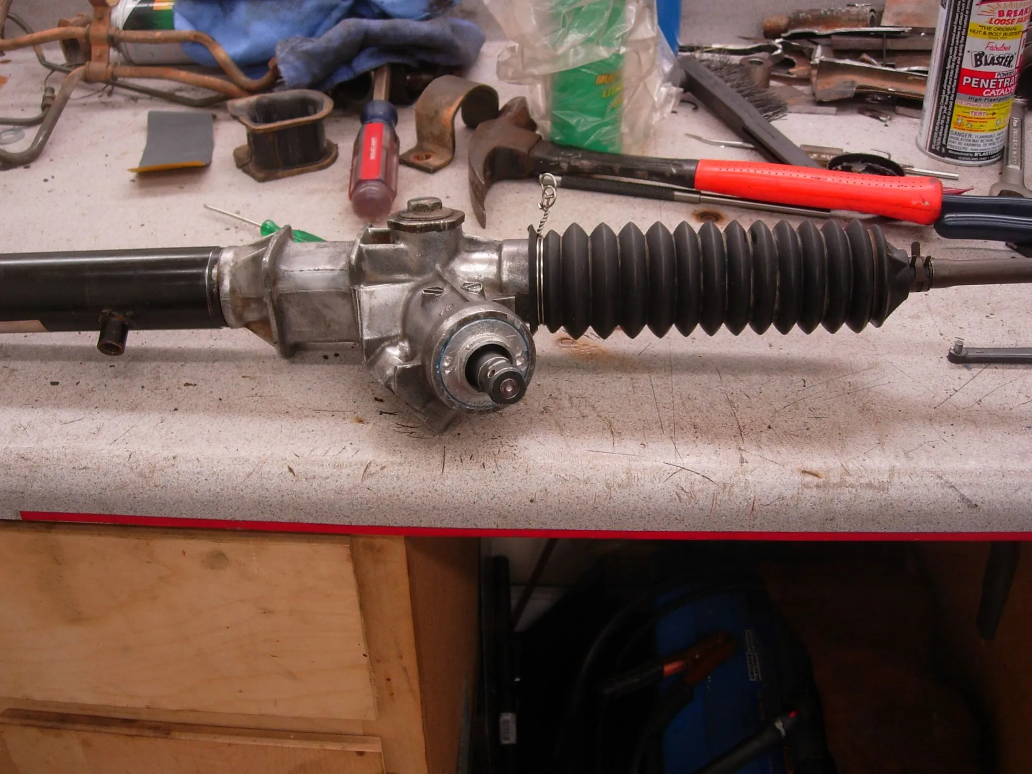

Steering Rack

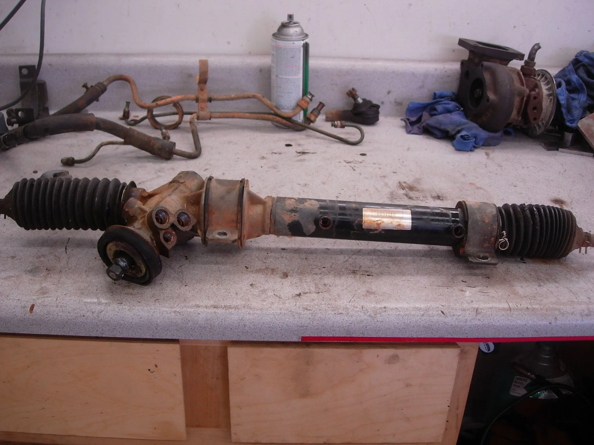

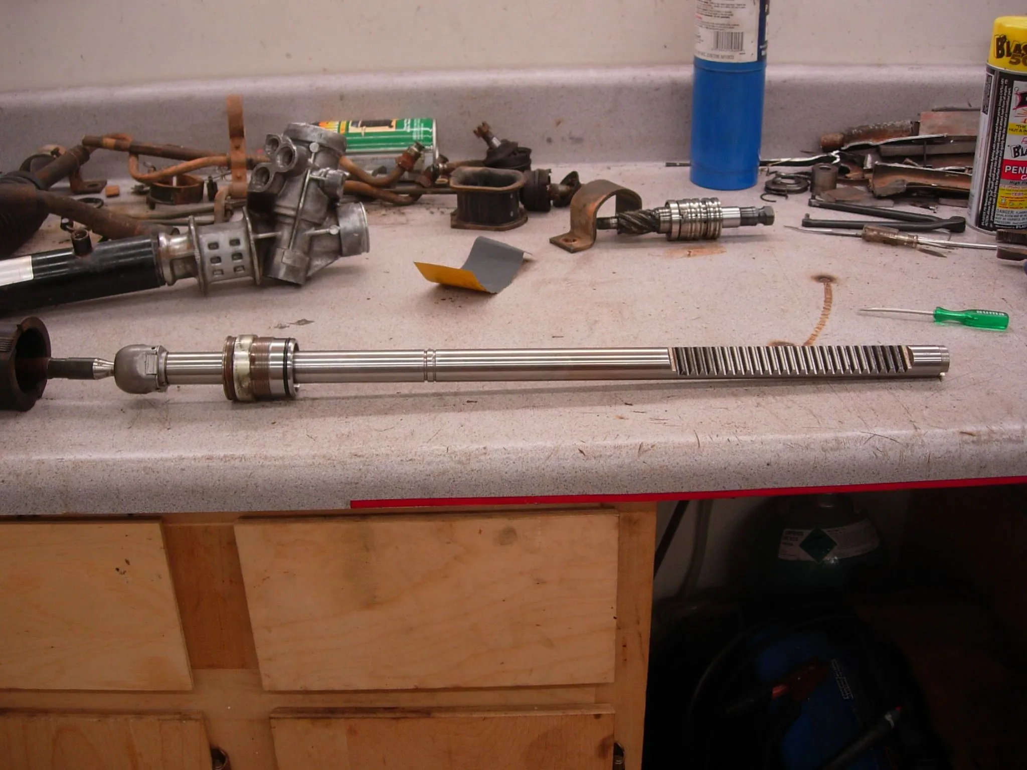

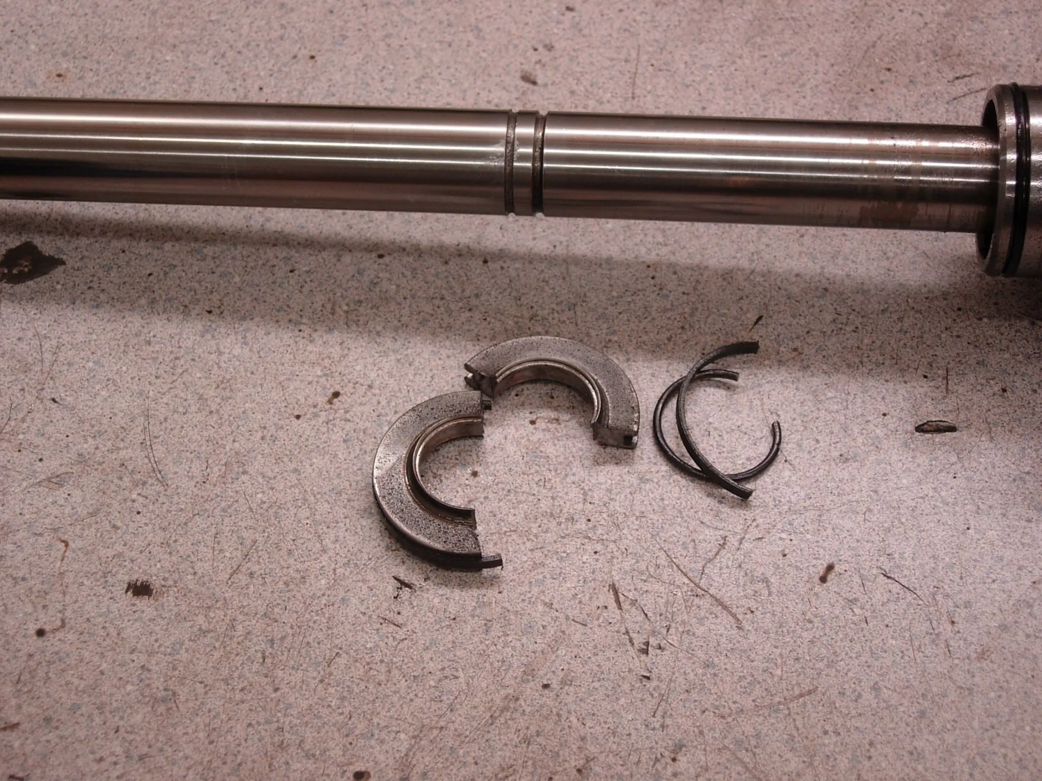

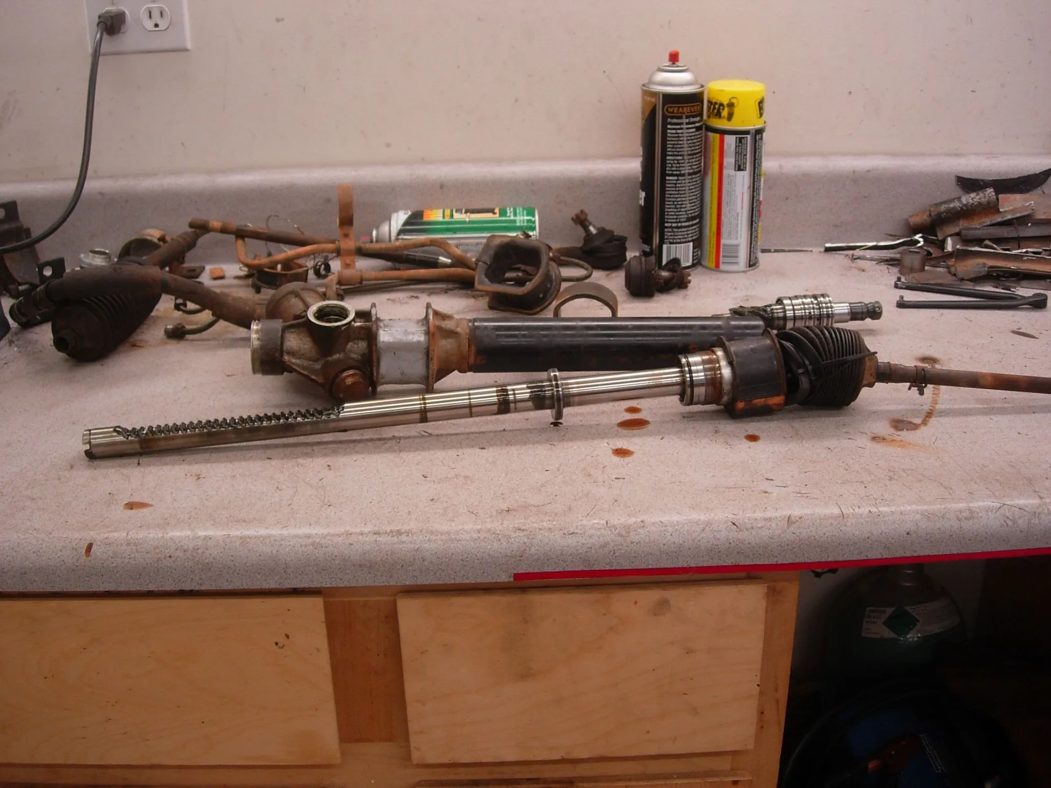

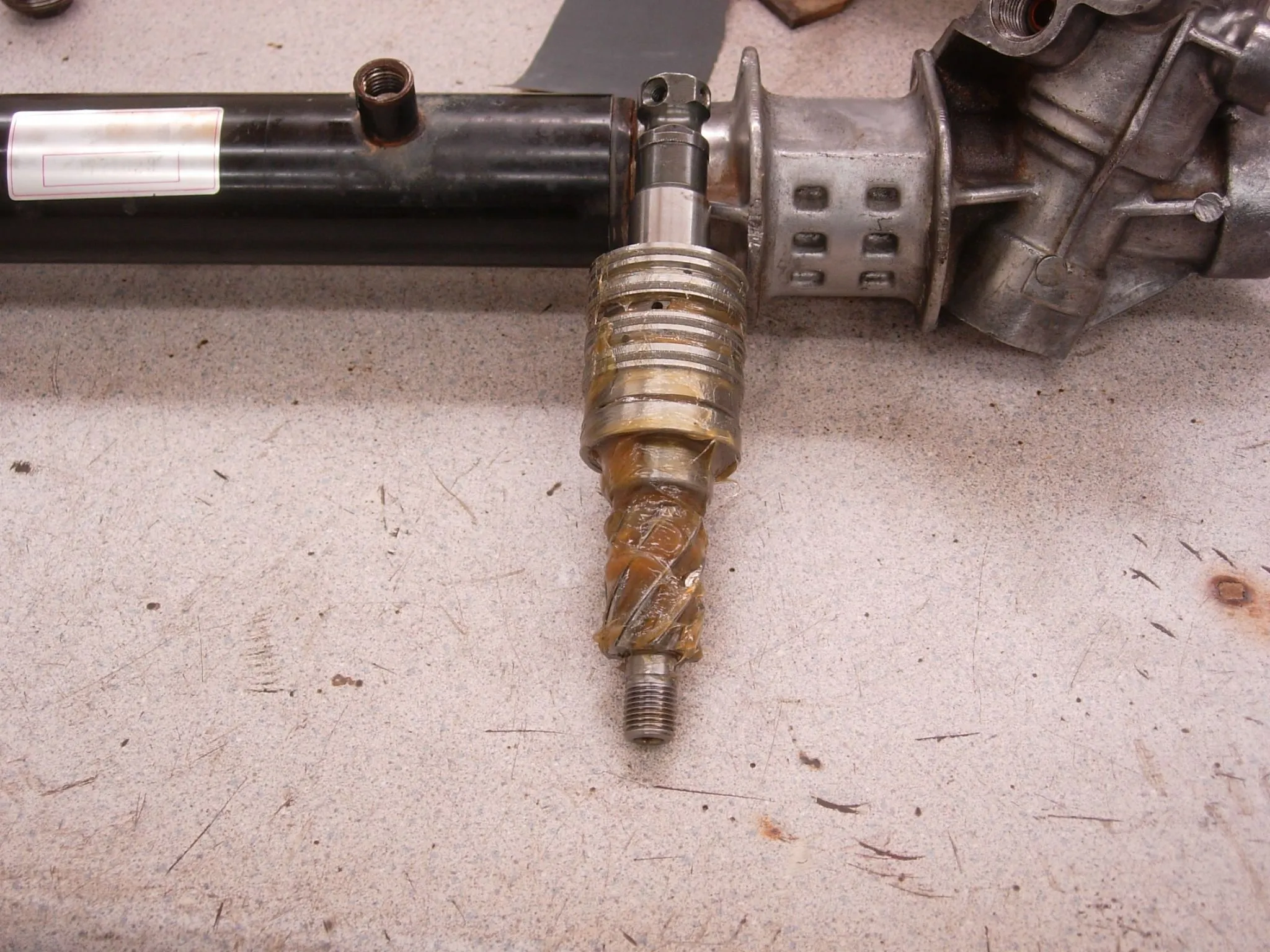

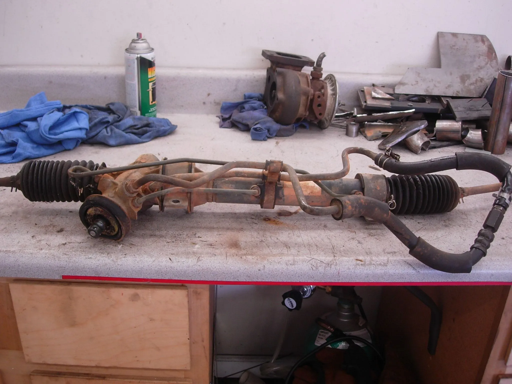

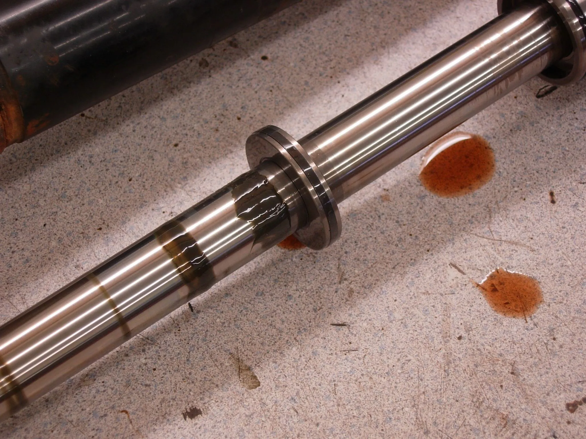

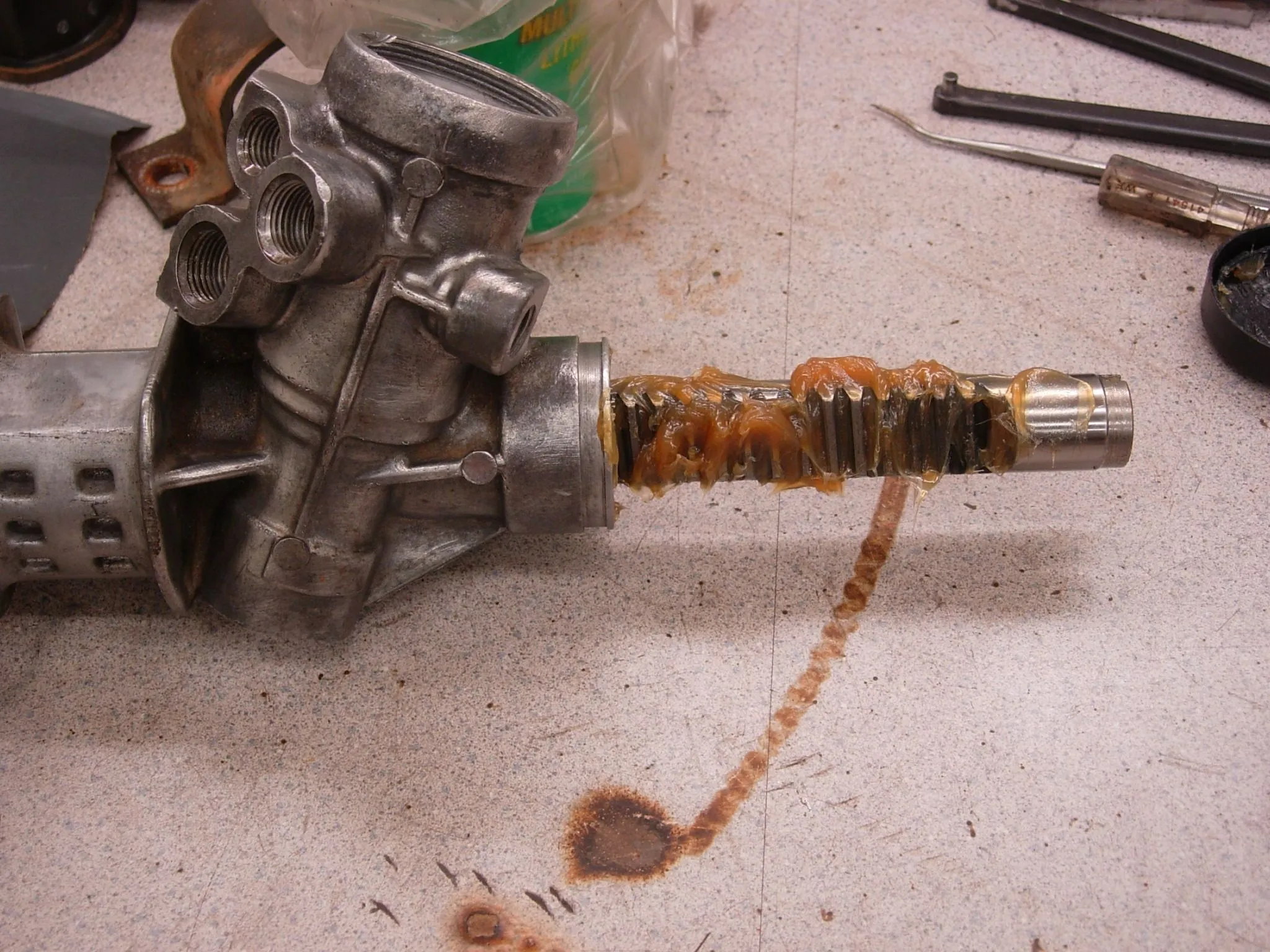

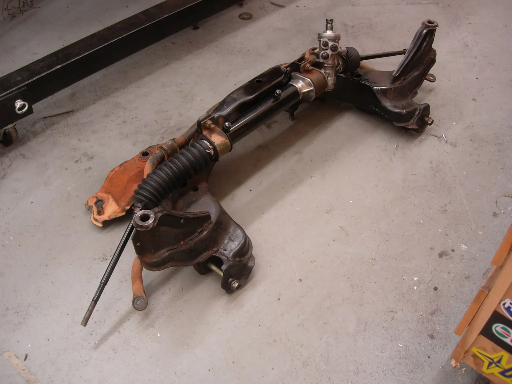

Looking back, I neglected to mention the steering rack. Since I neither care for power assisted steering nor the added weight to the car (at least when it comes to competition), I decided to de-power the power steering rack. Three options are available: by-pass the PS pump and leave the rack untouched, source and install a manual rack from an Escort LX Pony, or remove the inner workings of the rack that work with power assist.
It's difficult to find a Pony manual rack and I already had a perfectly good power steering rack [that came with the Tracer]. As always, I chose the more difficult route. In the past, I'd de-powered a couple of Miata PS racks and thought this one would be no different. It's a typical rack and pinion so all that was necessary was to disassemble the rack and remove a metallic bushing (I have no idea of its proper name) and o-ring. It's held in place by a pair of recessed circlips and is much easier to cut off. After making a pair of cuts on both sides and a quick swack of a hammer, it was time to reassemble. Furthermore, there are no costs associated other than a handful of grease. :)

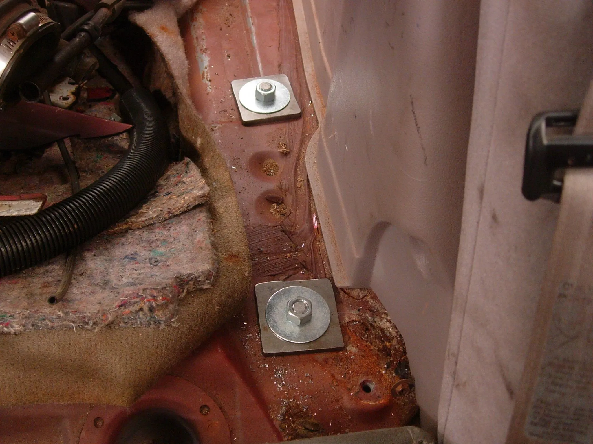

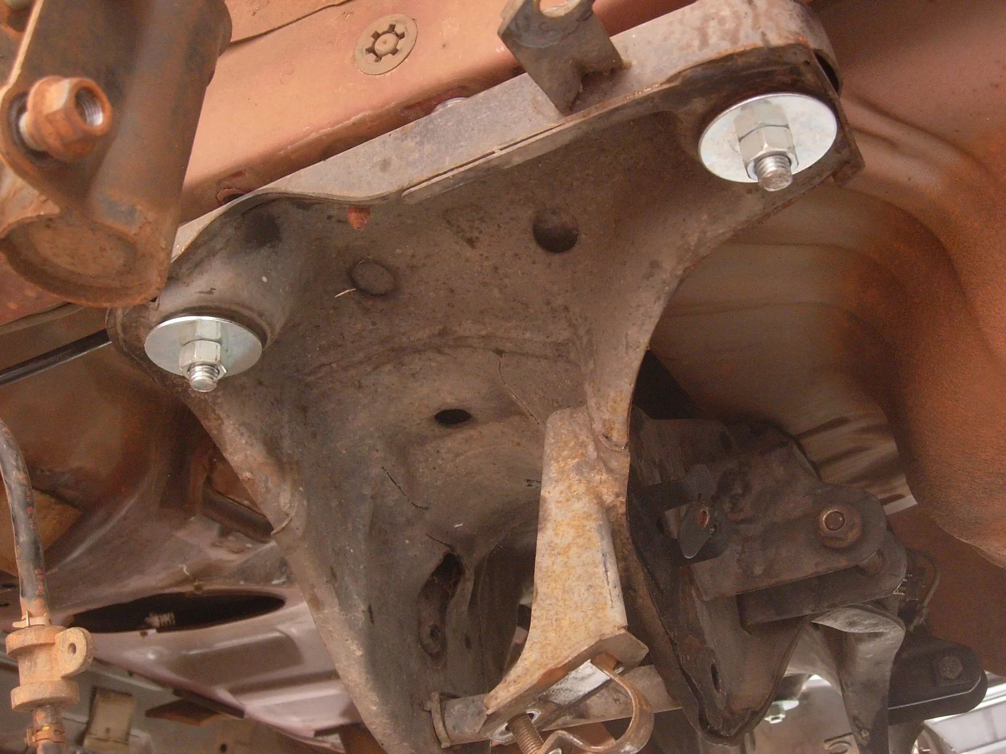

I put in a touch more work to finalize the rear subframe attachment this evening. Since the subframe was already aligned squarely with the original alignment dowels, I proceeded to drill through the unibody rails into the trunk floor using the original GTX subframe mounting points as a template. Then using threaded rod cut to length, secured it to the car. To ensure a square fit and overall proper alignment, I added make shift spacers above the original Tracer mounting bolts and aft-most GTX mounting point. The front most mounting point already sits flush with the unibody. I'm not happy with the rear spacers, but I'll leave them in place for the time being and will tidy it all up a bit upon final reassembly. I may box-in/reinforce the whole area with 12 gauge plate. Furthermore, I added a square of 1/4” plate above each bolt that protrudes through the trunk floor to add a bit more rigidity to the unibody sheet metal. This too may be changed later. I'll have to see how the subframe reacts whenever I finally get the thing on the ground ;) .
Tomorrow, I hope to either start swapping in the fuel tank or assembling the diff and various suspension components into the Tracer.
