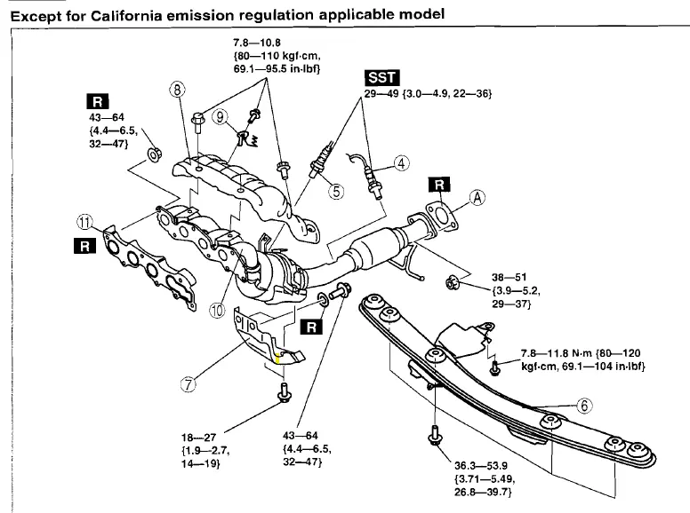

I've got a terrible rattle coming from my engine. When I last did my oil change in November, I noticed a triangular metal cover under the engine had a big corrosion hole and I think that's what's rattling. According to the factory service manual, it's the Exhaust Manifold Bracket, number 8 in the diagram below, but I'm not sure and I was wondering if anyone has a clear photo of a Gen 1 MS3 underside with the splash guard removed so I can confirm? How difficult would it be to replace myself (I've got access to a lift)?
