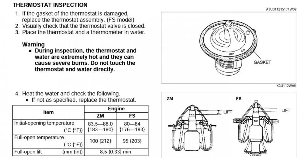

I've got this for you though...

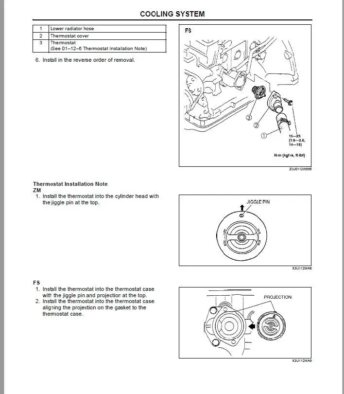

Make sure you have a thermostat with the "jiggle pin" for your FS engine and it is positioned properly as shown in the lower part of the illustration.
I've also noticed that on your instrument cluster water temp gauge, the bottom line is 100*F and each hash line above it is 10 more degrees.
So counting the lines up from the bottom line the normal operating temp is around 190* and a quick glimpse at it will be just below the gauge pointer pointing at the 9 o'clock position.

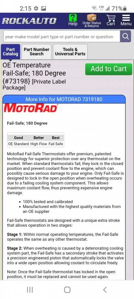

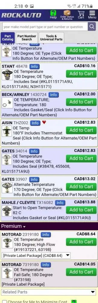

I found this at Rockauto...
It looks like you can get a 170°F or 180°F thermostat.
Here's the fail-safe version.
It sounds like a good idea.
