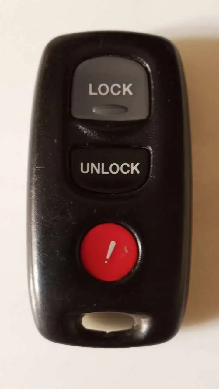

I got my P5 with two keys and no remote.
Mazda wanted $184 for an OEM remote.
I got two remotes at a wrecker for $10.

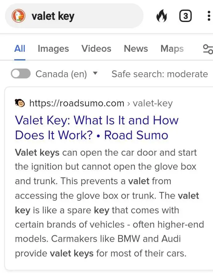

My car came with two keys. A valet key and a regular key. (I think?)
I'm not positive, I also had a 1985 Mazda 626 that may have had both keys? But I'm pretty sure that I could lock the Valet out of my glove box and tailgate with my P5.
(it doesn't work for the tailgate. You just fold down the rear seats to gain access, but you can lock your glove box.)

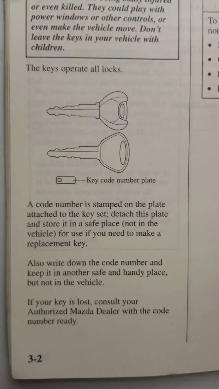

I found this in my owners manual.
It looks like the keys are the same and open all locks.
ive seen MZ19 and MZ31. One for ignition and one for trunk or just different years. I just need to be able ti move it around. Thanks !
I guess the different part numbers are for either the plastic covered key or the plain metal key.
(the valet key must have been for my 626)
