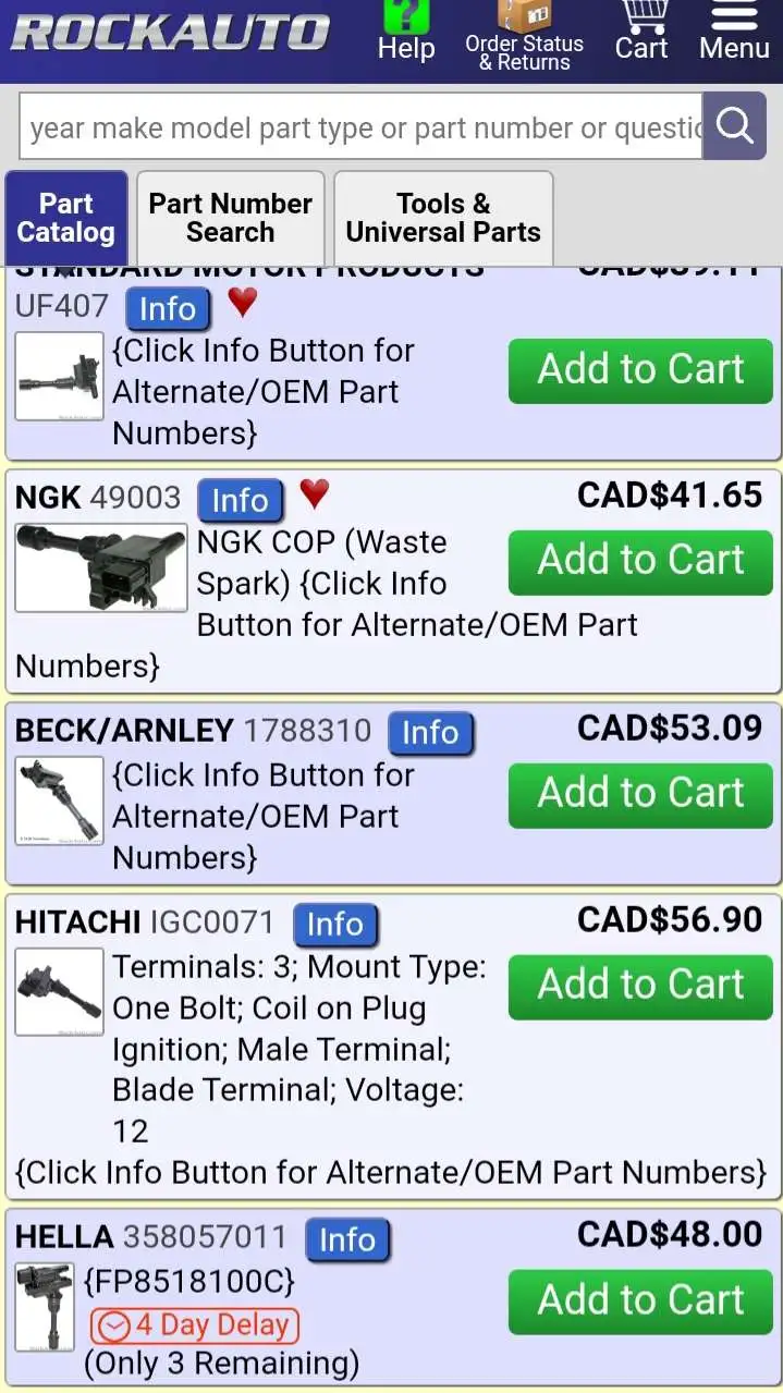

Coils can be a real PITA on the P5 and brand new ones can fail and misfire.
Hitachi coils are the best for our car.
They are the most expensive, but we'll worth it.

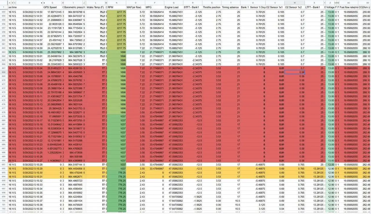

Thanks all for your input! The coils are working well, and it's a manual so it technically does not have a "limp" mode; So I ran a test on her this morning and logged all the sensor data for the drive. It's only doing this when it warms up so my speculation is that when it goes into closed loop it is getting bad information from one or more of the sensors.
Attached is the image of the data (Each line is a second) of the sensors. As the issue begins, the B1S1 O2 & STFT goes to 0, and pretty much stays there for the rest of the data. The MAF also seems to immediately shoot up to pver 7GPS, and goes down into the 3s.
After it starts running like crap, the exhaust out of the pipe is also very very strong. Normally you can feel some exhaust coming out, but when this is happening, it's hard blasts of air. I am assuming from the engine going extremely oxygen rich.
My guess right now is a bad o2 sensor, and it's reverting to trying to run off just the MAF which is going to result in really bad performance.
You can view the data in full here:
Let me know what you think about the data if you take a look.
Thanks Guys/Gals!
