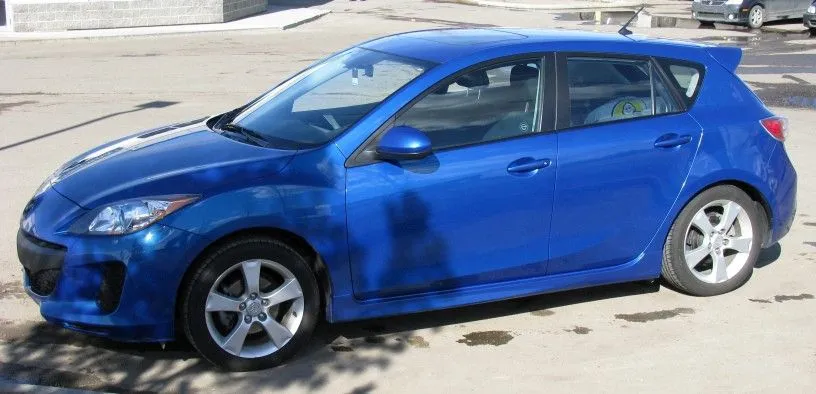

This may be too late to be useful, but I just joined the forum...
I bought used OEM 17x6.5" ET 52.5 wheels from a first-gen GT sedan and put them on my 2012 GS-Sky sport (hatch). They have original-size 205/50R17 tires on them (but not the tires originally provided by Mazda). I have no fit issues. They are very similar to the Mazda5 wheels shown in the other thread; I think this style suits the second-gen body style well, but frankly appearance is quite low on my priorities.
Thanks for posting. Your combination looks great. I haven't made a choice on wheels yet, but now that I've actually seen it this may be hard to pass up. Are you stock height?
Sorry it has been a week... I'm not into the habit of checking this forum yet, and it doesn't seem to send notification of responses (I'll look into that).
Yes, my car is at stock height. Other than this swap, the car is dead stock.
