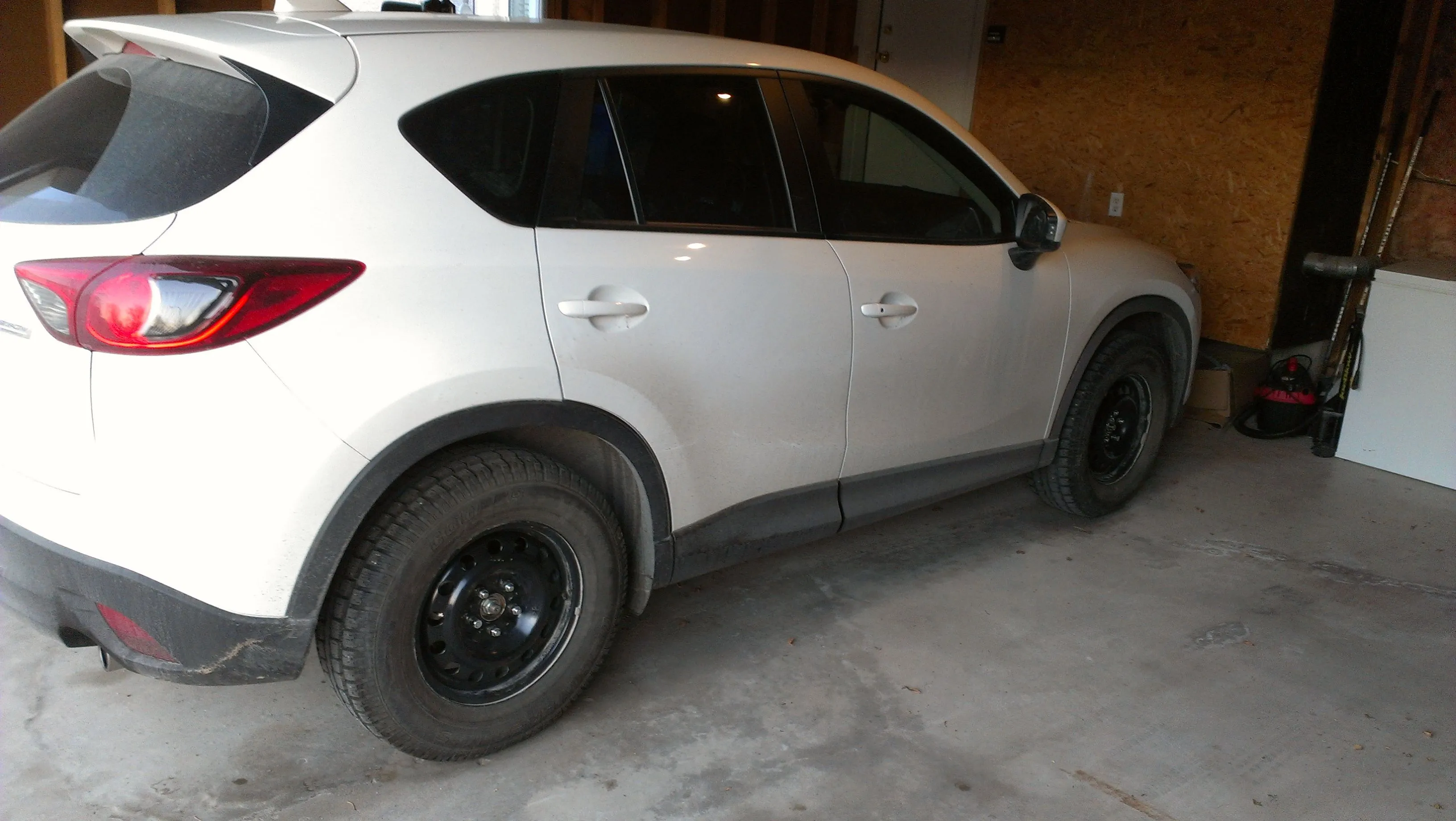

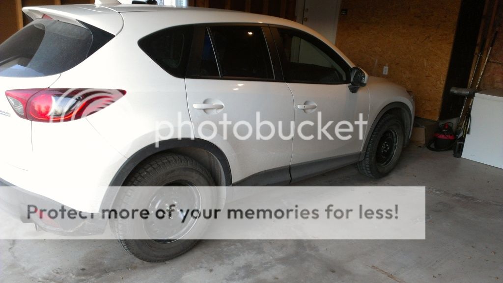

16s with winter tires on gt

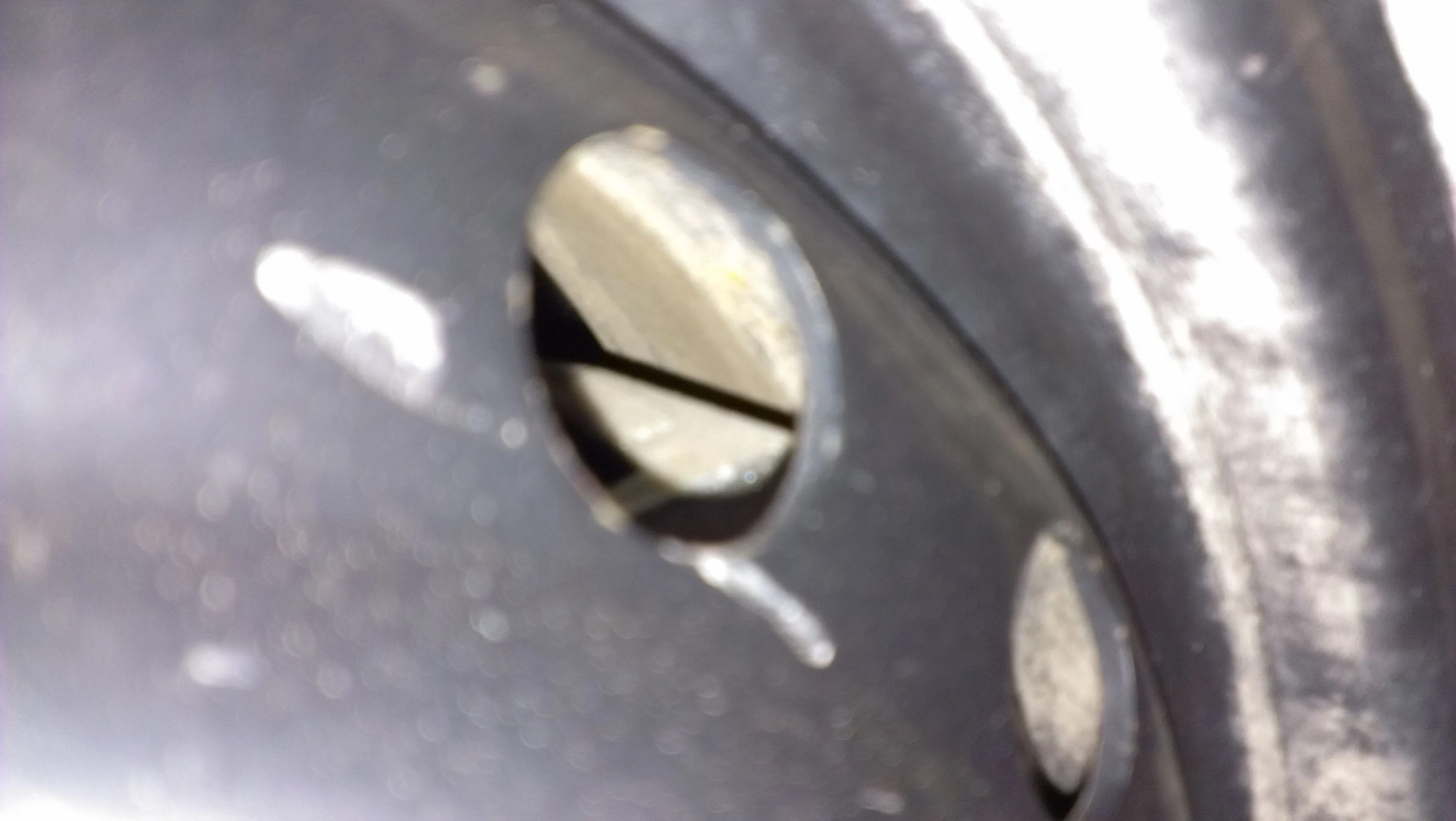

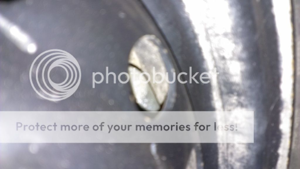

Rear wheel caliper spacing...

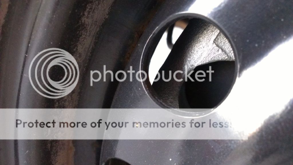

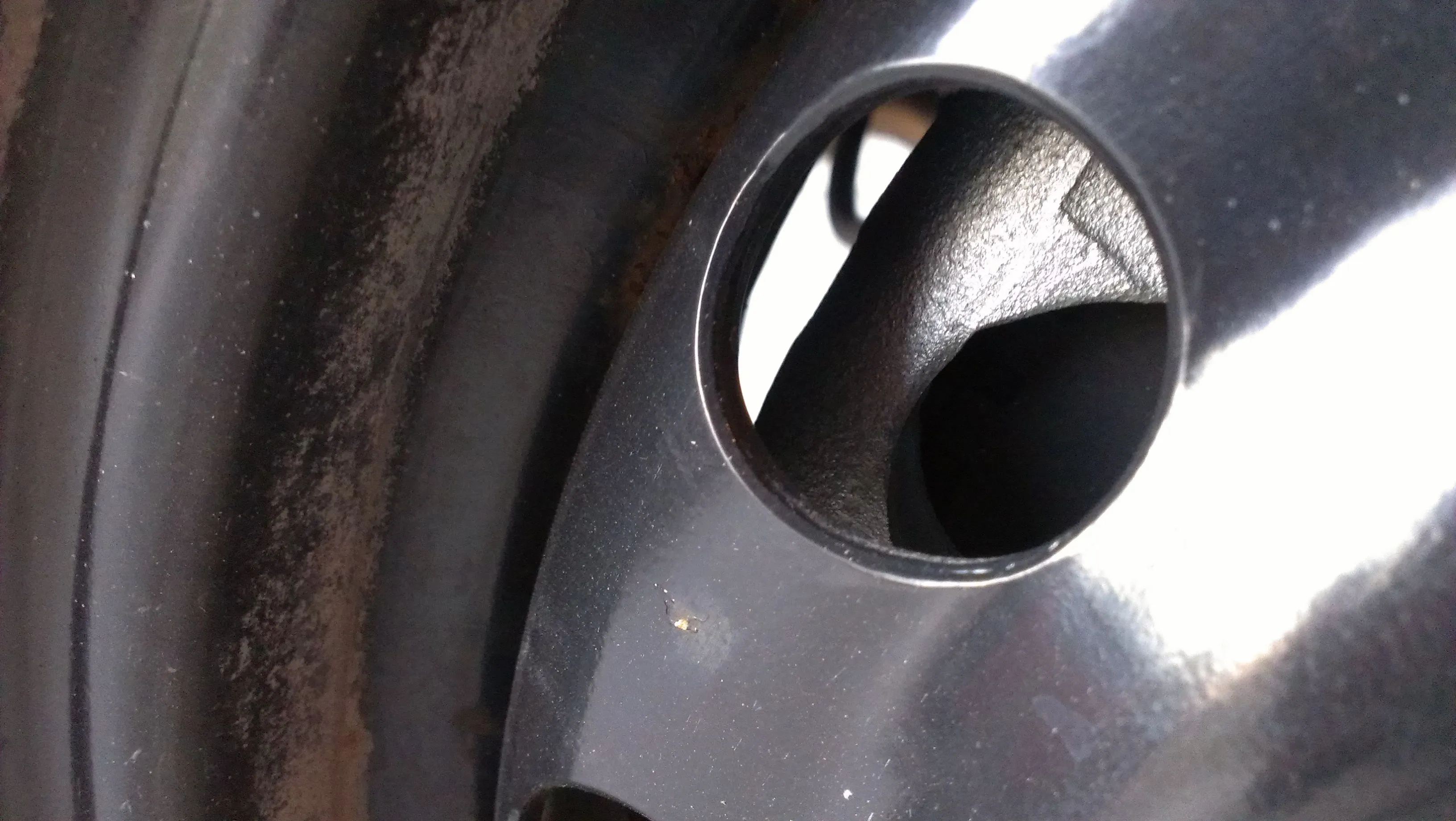

Front wheel spacing, best pic I could get with cell phone nearing dark....It's got about half an inch of room.

Actually they look way smaller in the pic for some reason. The actually look nice and beefy in person. The actual overall diameter is almost identical to the stock 19's. My speedometer and nav speed are still in sync. For some reason clicking the attached pic looks better than the posted one, almost like it is stretched.
most probably price and availability of winter tires.....
They were winter wheels from my 2005 escape I traded in. Turned out to be the same bolt pattern, center bore and within a 1/4" overall diameter.
They are cooper discoverer M+S P235/70R16. It's the stock size of my old escape. The handling is surprisingly good considering the drastic change. The escape was mushy and rolled like crazy with them. Guess it was just the escape itself.
Not ideal in snow being slightly wider but they'll be a hell of a lot better than stock 19s on those nice rims I don't want to smuck against a curb.
I kind of like the beefy look of them for winter
My dealership highly suggested the 16 inch on the GT AWD for better traction. all i know is I can't wait until March 15th to get them off.
Oh, I don't know. My 16" 70 series winters don't look that good, and they don't corner as well, and they are if not noisier at least do have a lower drone note on the highway. What they offer (aside from the better snow performance which the weather has not yet allowed me to confirm) is a notably more comfortable ride.
