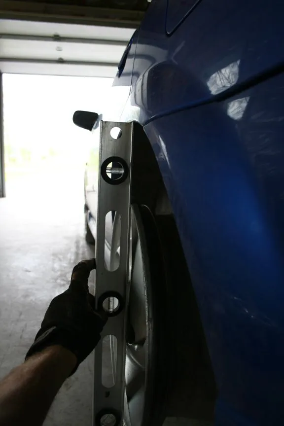

40mm sticks out a bit

Before that I had 195/50/16 on +40 16x7 Rotas. No rubbing but it was close and it looked as if 205/50/16 would rub. 205/45/16 or 205/40/16 might work.
Here's the 205/50/16 on +40 16x7...
well...I tried fitting them on and, the fronts fit no problem. Even in solo2 conditions, I had no problem at all.
The rear tho. I could move around in the parking lot and it would not rub. But I decided to go park with my rear wheel on a curb to see what would happend if it was to compressed. And here is the results.
So I dont think those would fit without modifying the fenders somehow.
