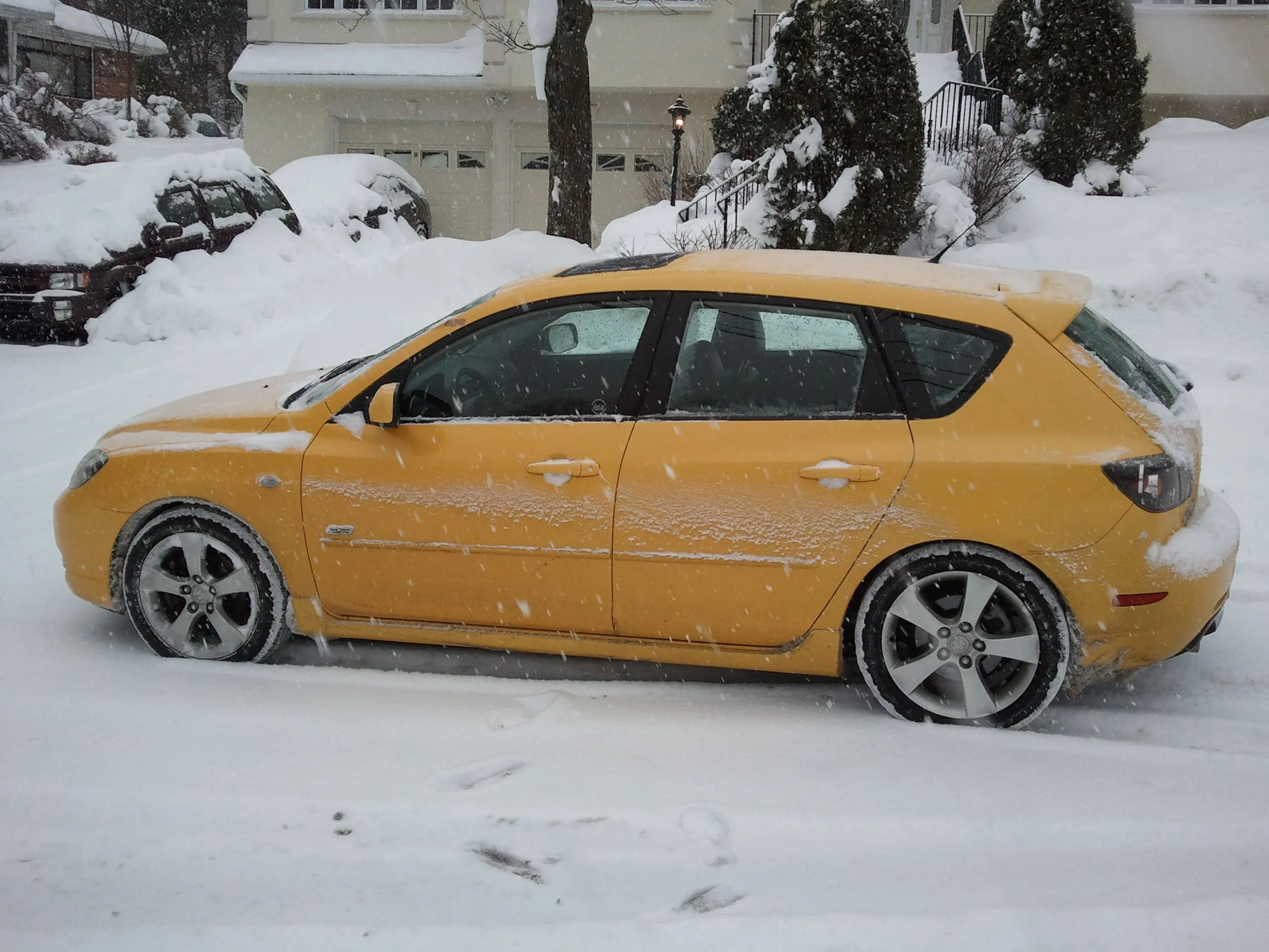

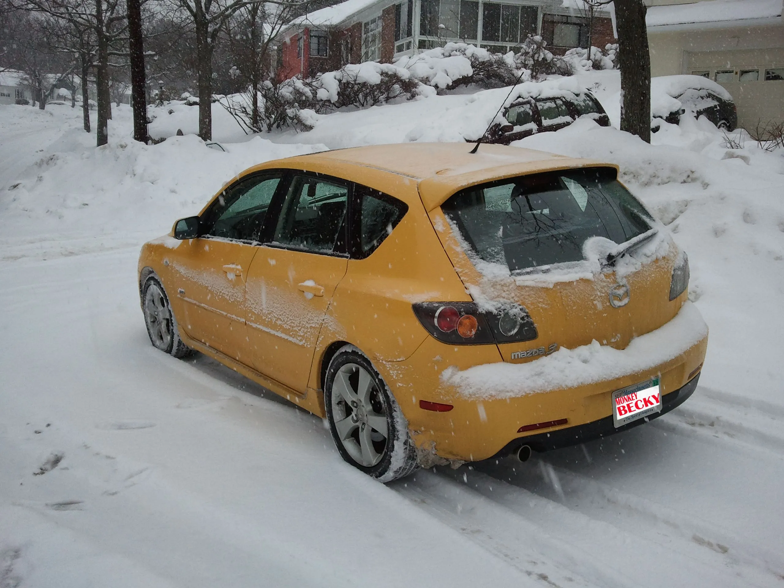

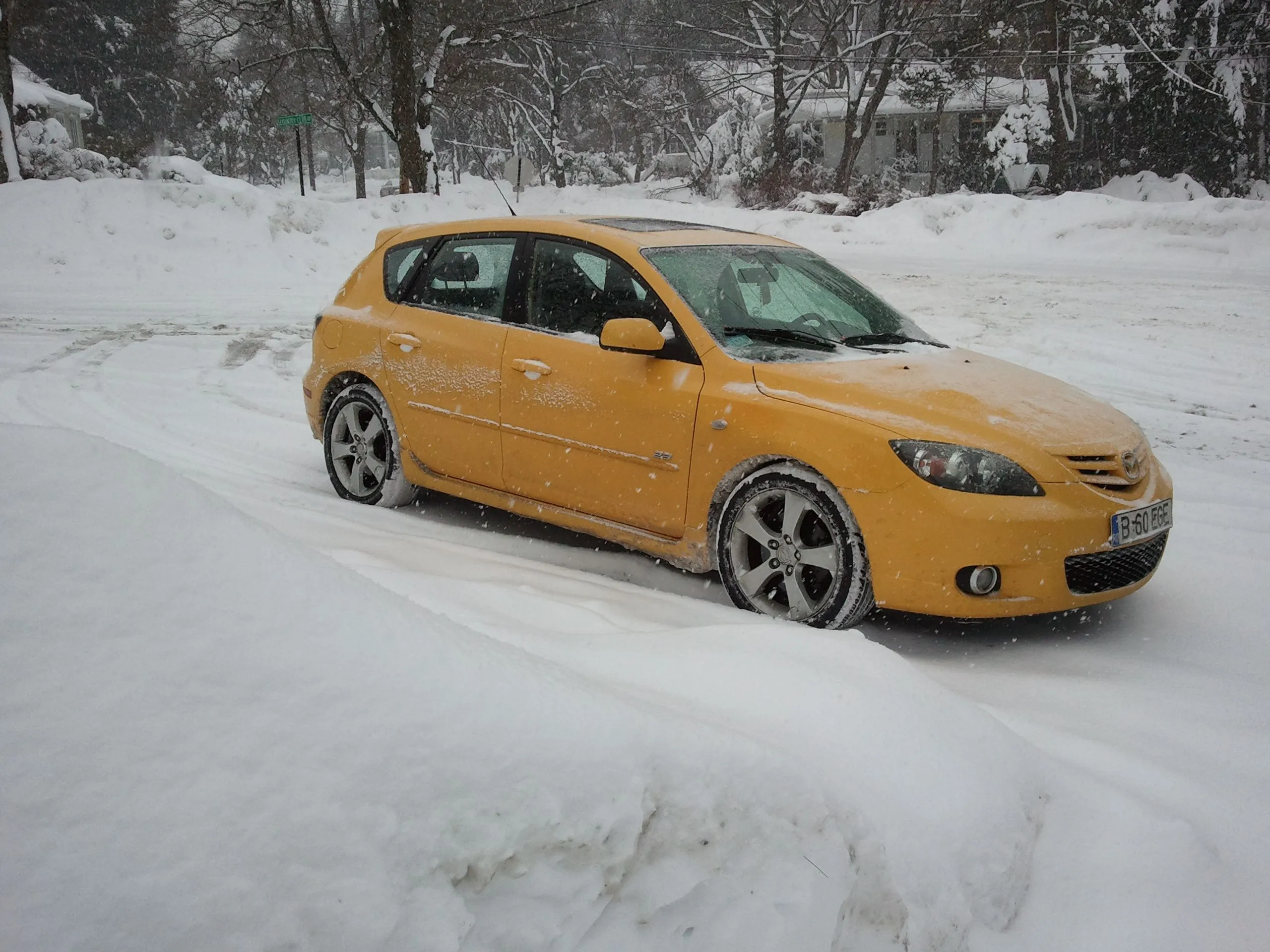

It would appear that you are lowered. I would say, and this is a guess, without negative camber +40 offset should be fine. Stock wheel offset is +52. The lower the offset the farther out the wheel is. Be carefull with spacers, too thick and the short wheel studs are not going to keep the wheels on.
actually im not lowered..its the snow effects but im thinking of lowering it a bit in the future it looks so much better.. ill post a picture of the car without snow. But what im understanding is that anything lower than +40 might rub against the fender?
Offset is useless without listing the width of the wheel and the tire size you are running. Generally speaking, an 18x8 +40 will probably need a roll. You'd probably have some rubbing over bumps, when turning sharply, or with people in the car.
If you are not going to run a 225/40/18 tire on your 3 don't even bother with 18s. I had rubbing with 215/45/18s installed on stock ms3 wheels and they weren't even spaced out at all.
Wow, really? i hate rubbing, i feel like im being touched personally, but why were you rubbing? Were you lowered? Werent those stock rims and tires? Well first off, i almoast never have more than one person in my car. Its always me alone or me and my girl or friend and i dont carry anything in the back, so im pretty weightless.
What im trying to achieve is to fill in the gap of front and rear especially. I hate the designs in which it looks like the wheels are tiny although this mazda did produce some really nice factory rims (205/50/r17 curently pretty thick tires). I do not have money for a lowering kit which will probably run $1k+ and it probably wouldnt be smart with such terrible roads in/around Boston, highway also. Although i need new struts, its getting pretty rough riding.
I want the max flush fitting i can get without much customization. Right now with the current rims and tires (picture 3 & 4) it looks like i can definetly fit an inch more, although i have 50mm thick tires. Bottomline Chef, what would you think i should go with?
